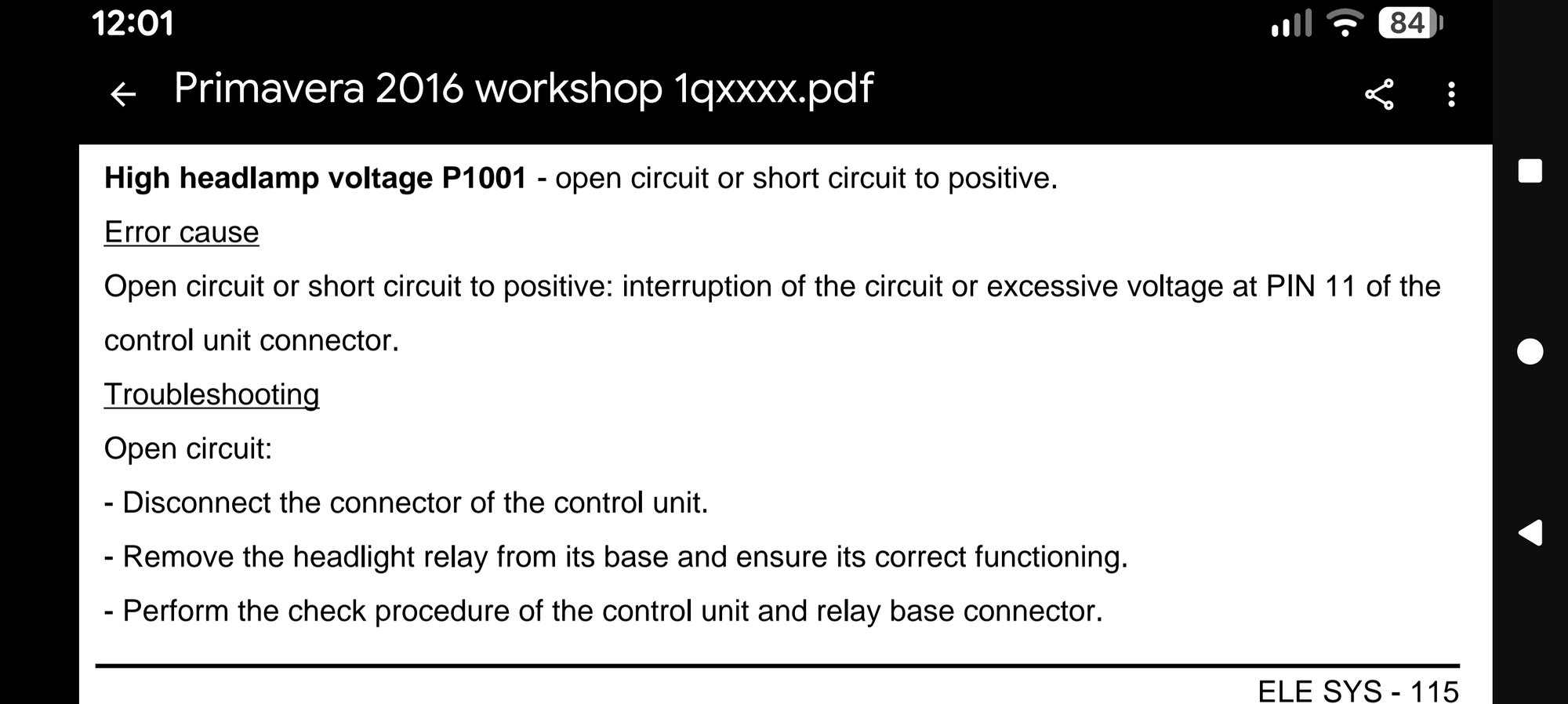

Depending on which ECU ....
2023 Sprint 150 S (TFT display model), but I doubt there is an actual fault. The FXTUL seems to only detect a fault after boot up of the tester. Any tests ran after that initial first test after boot yields a Pass.
