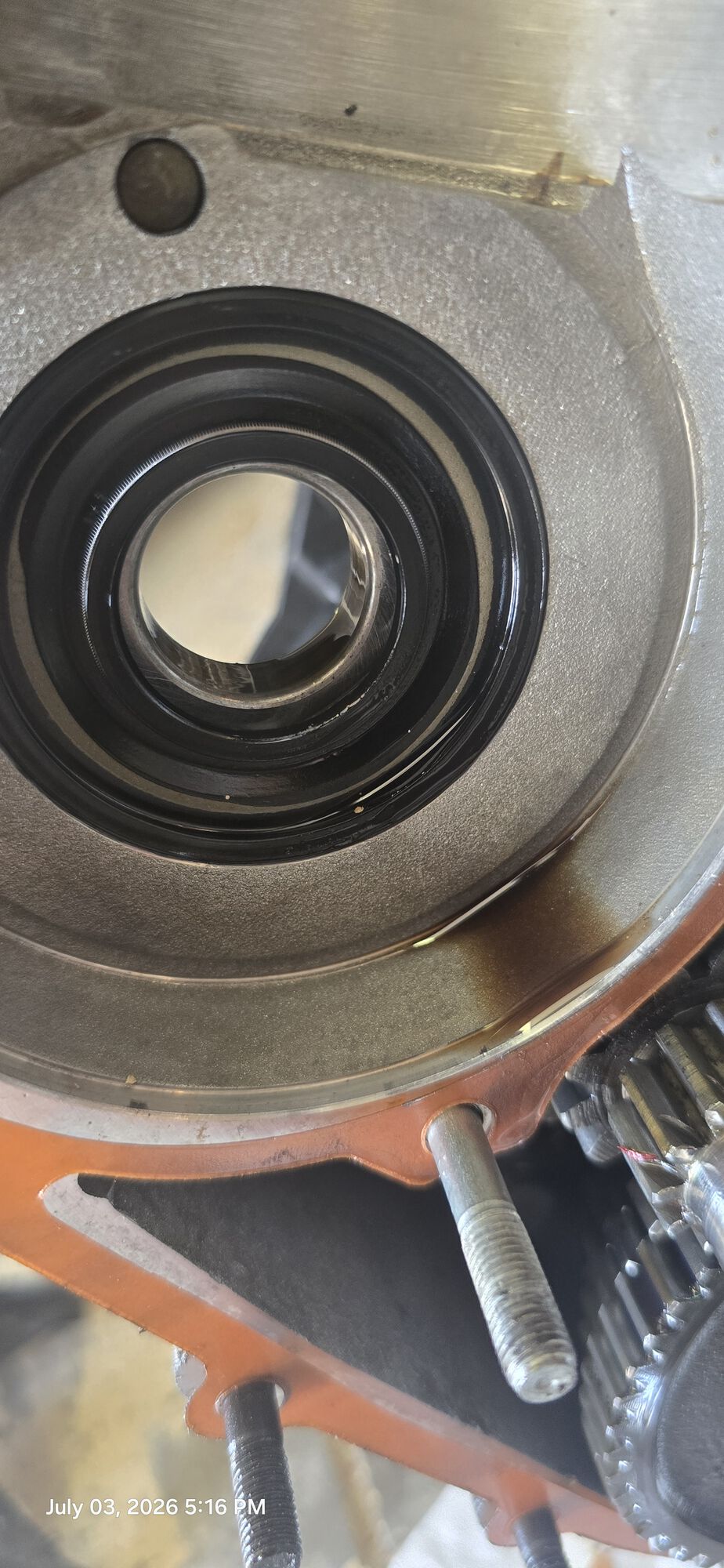

This was the last time it was open. No visible damage. Oil obviously getting in around crank. This time I installed a blue Corteco seal. Haven't pulled it apart yet but, ran beautifully, then started acting lean on the last leg home. Now smoky idle, can't pull off from 1st gear. Leaned idle down but, will "flood" and die.

Soinds like ethanol damage
You should look to ethanol resistant seals

Agreed. Neither the black or blue are ethanol resistant. Use a BROWN Viton/FKM seal.

I use only ethanol free fuel. So, there's that.

Either way. The brown seals are far superior

Got a picture of the crank seal surface? Tested the crank for straighteness?
This.
I've had cranks twist out of true and kill seals multiple times. Also, check if the big end pin has pulled out of the web at all.
It's always been the fly side in my case, but that could just be bad luck.
Once it happens, you need to get the crank back to true, then weld the big end pins or it'll just keep happening.

Thought so as well. 3rd seal. New Crank. New bearings. Also, I've owned same bike 20 years and did stock overhauls 3 times previous without issue. That's why the cursed logic is at play.

New crank could have been crooked to begin with though.

Curious if the Mazzi cranks are just flexing under pressure. Consistent with first 3 rebuild symptoms.
1st: Ran about 50 miles, was able to tune it in. Performance flagged off and started sucking oil.
2nd: same crank, new seal. Ran for about 1 to 2 warm up runs, sucked oil. No visible seal damage.
3rd: New Mazzi crank. New seal. Ran beautifully for several.around town. Did a 60 mile ride, started coughing up about 5 miles from home. Limped it. Tried to start next day, blowing oil.
Yet to get into the seal for inspection.
Have the brown Malossi seal.
May just bite down on one of these regardless of the condition of the seal.
https://www.racingplanetusa.com/crankshaft-touring-rotary-valve-57mm-stroke-vespa-px200-p-222960-1.html
That and a BGM lightened flywheel.
@chandlerman avatar
Innovator
Posts: 13220
Location: Nashville
365 Days Since Last Explosion
Innovator
@chandlerman avatar
Posts: 13220
Location: Nashville
Did you check if your crank was true? Is the pin not fully in place?
I've been burned by Mazzi cranks a few time, but if you get them trued up, then weld the pin, they'll hold together.
@chandlerman avatar
Innovator
Posts: 13220
Location: Nashville
Innovator
@chandlerman avatar
Posts: 13220
Location: Nashville
Also, is there a reason you don't go to the 60mm crank?
You're almost certainly leaving loads of power on the ground because you probably still have absurd squish and random port timings.
