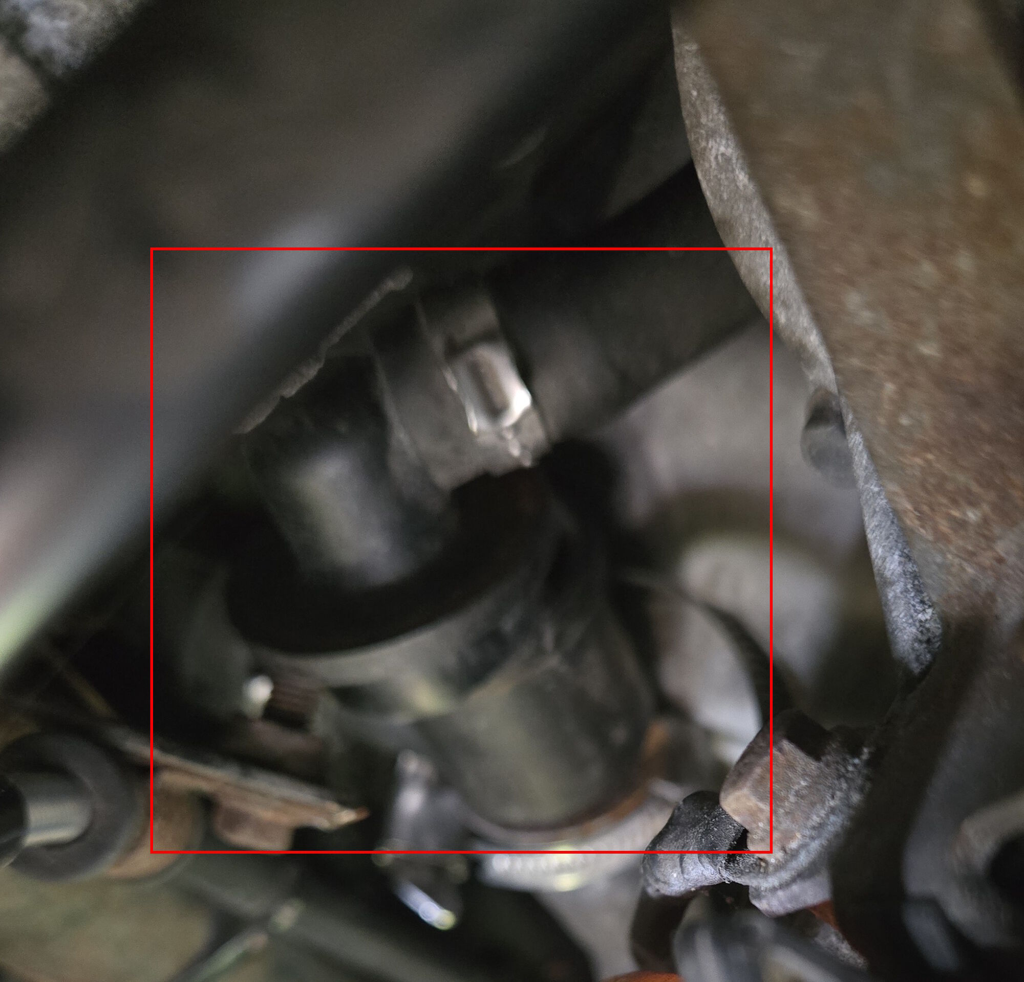

Hi,
Can anyone tell me what this part is called? My MP3-500 sprang a leak some time ago. I believe the clamp that kept these two hoses together rusted away. I can't seem to find the part on any website or diagram. There's a spring in the bottom hose which appears to push on a valve. Any ideas? Sorry for the blurry picture but it's the best one I managed to take.

What kind of leak? Engine oil, coolant or ???

It looks like coolant.
It is just 90°, corner part.

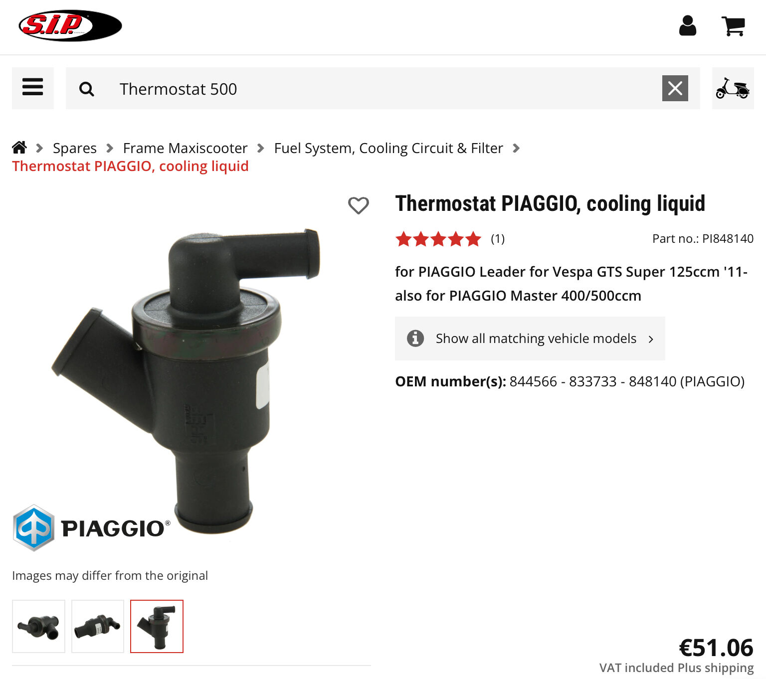

Probably the thermostat

Thermostat…

That's the one. Thank you!
