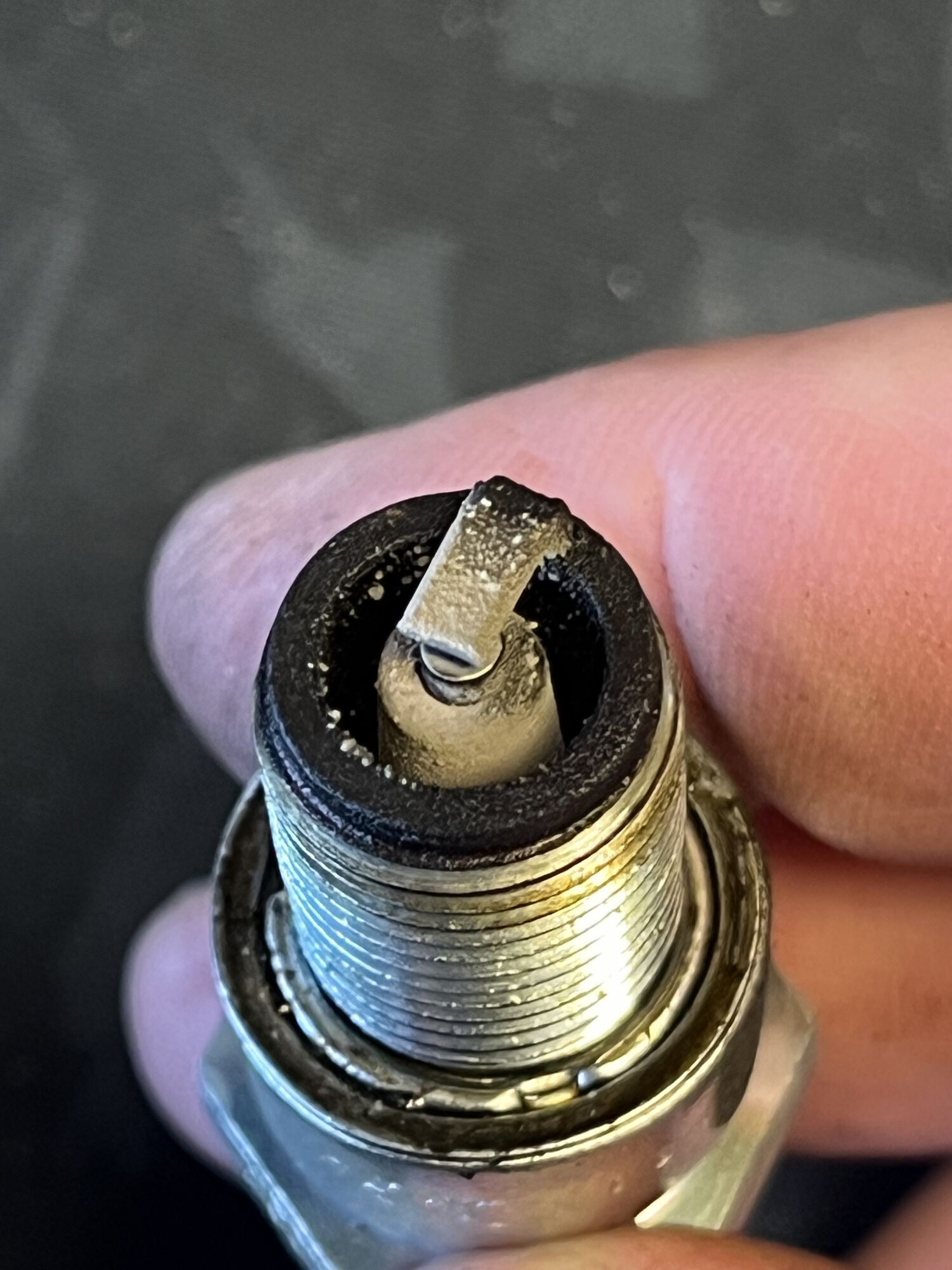

Ok, I got a new BR6ES plug, and when I pulled the original plug, it was a BR7ES, tip was ashy and white, lean mixture. After reading a few old threads, it seems that the general consensus is to stick with the 7 or even go to an 8.
I may try the BR6ES for a ride and see what the plug looks like, but I'm hoping that after I clean the carb this weekend that the mixture might balance out. I primarily ride around town, shorter trips, so from what I've read, the 6 should be ok, but open to more experienced suggestions.

Here's a pic of the current plug
Pic of BR7ES
Pic of BR7ES

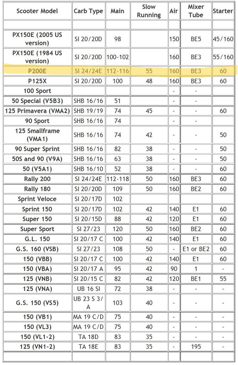

Holy cow that's lean. Is that bits of aluminum on the top of the ceramic?
What jets are in there currently?

Best I can tell with my old eyes is 118

Old plug gap was only .03 as well; not sure if this makes much a difference. I've gapped the new plug to .06

That's what it looks like to me! Super lean! Time for an air leak test! If a borescope is available, remove the spark plug and see what the top of the piston looks like.
All the jets. What are all of them currently?

Ah... only one I pulled last night was the main jet. I'll pull the rest tonight and see.
Previous owner gave me a random bag of bits and parts; had what looked like a set of old idle and main jet, and as much as I tried, could not read any numbers on them.

FWIW:

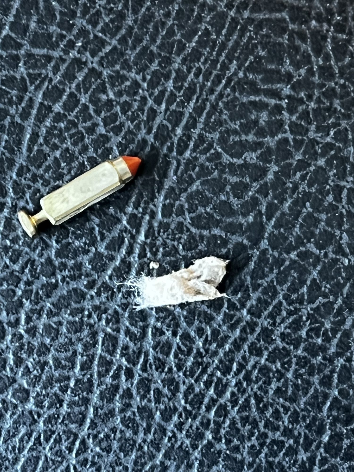

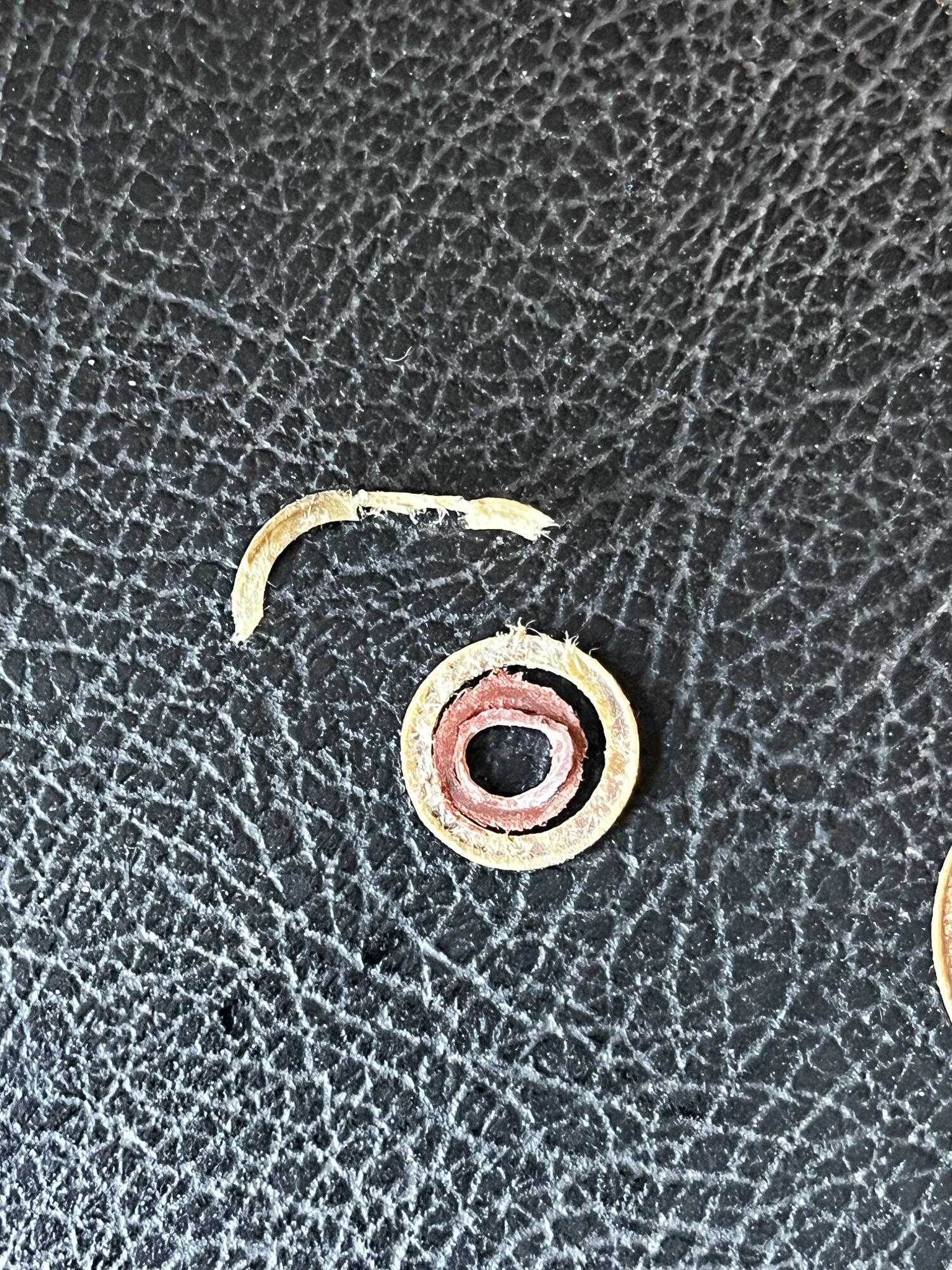

I pulled, cleaned and rebuilt the carburetor tonight, new gaskets, air box seal, etc. and found that the banjo was definitely the culprit, and I found what looked like a lump of cotton or paper towel at the entrance to float bowl. (See pics). I think I found my fuel starvation issue…
All I need to do now is readjust the idle screw and pilot mix screw, then test ride tomorrow
Banjo gasket condition
Lump of cotton (?) clogging banjo. Needle valve for size reference.

Hopefully final update:
Cleaned and rebuilt carb working great, power dip and fuel leak issues gone. She's riding great!

Was definitely leaking from the banjo, as the gaskets had deteriorated and flaked off, which led to clogging the banjo inlet.

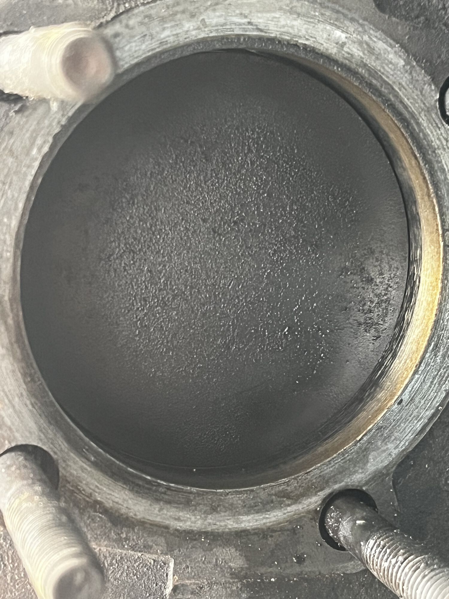

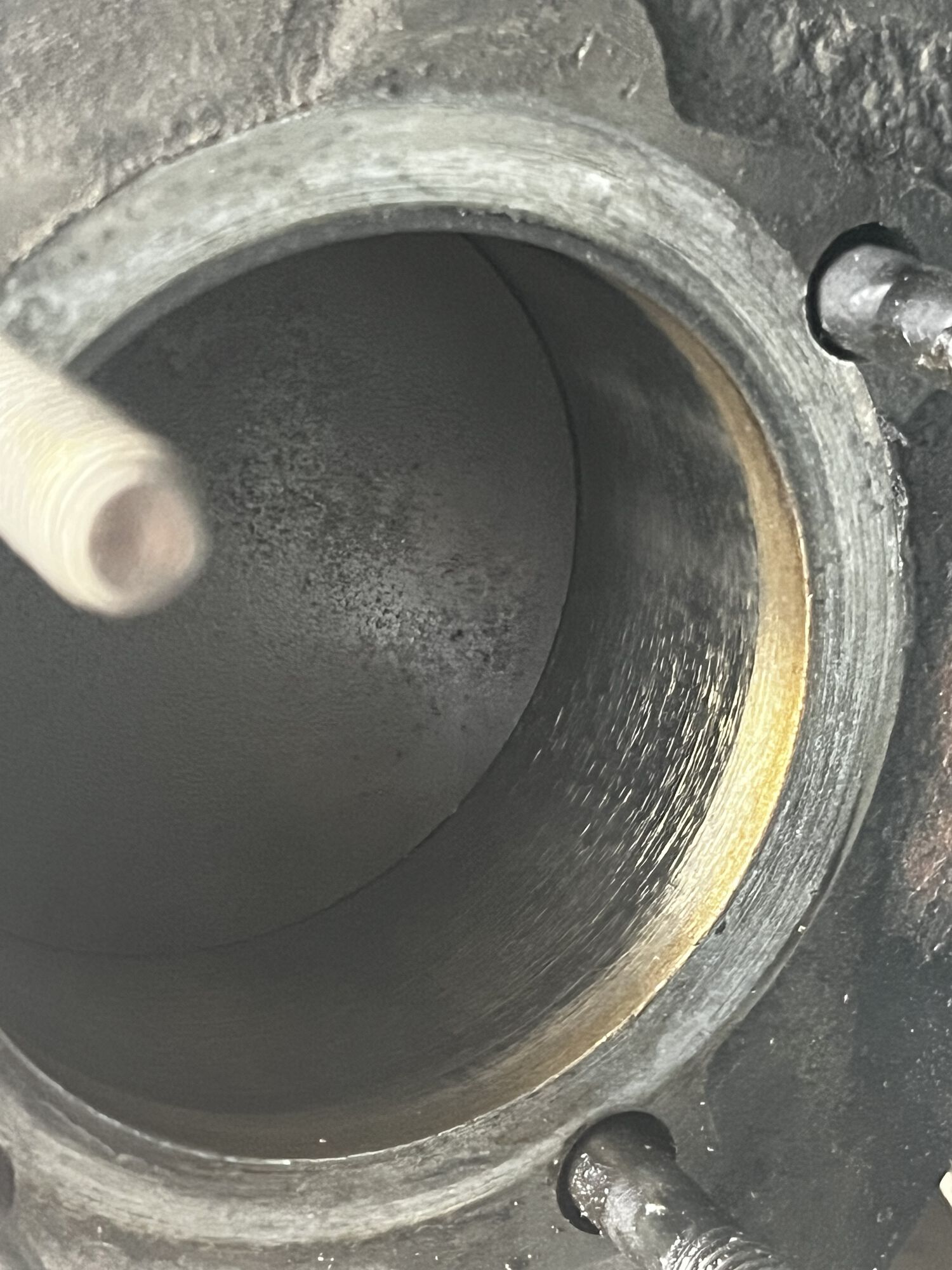

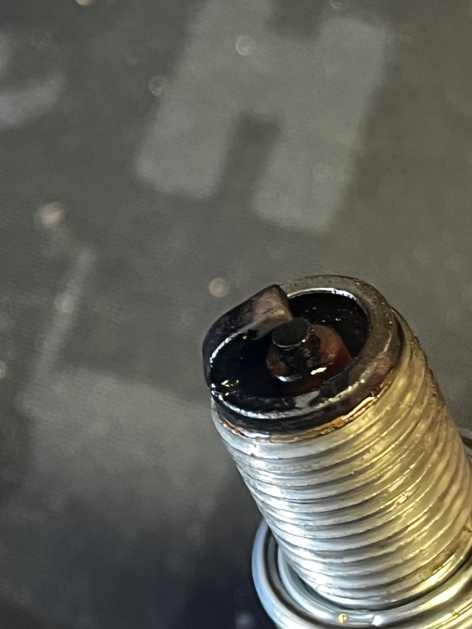

Decided to pull the head and just inspect piston head and top of cylinder. See pics, but didn't seem odd to my limited knowledge. Cylinder wall was smooth, no evidence of vertical scoring, coated in thin film of oil.
Spark plug is darker brown and wet looking.

Spark plug (BR7ES)
Spark plug (BR7ES)
Cylinder wall
Cylinder wall

Looks like 'Oil Sucker' issue. How's the gearbox oil??

Nevermind.. looked up the oil sucker issue. Seems to be what I'm dealing with for sure. I have an appointment with Massimo's Vespa Shop next weekend as this issue may be beyond my current skill and shop ability. Appreciate the info!

I guarantee it's not beyond your current skills. I'm an idiot can do it! But really it all just seems harder or more daunting that it actually is. Just grab a torque wrench and you'll be fine.

My 79 P150X is doing the same thing. Losing power up a hill. It seems like it's not getting enough fuel since this also happens during high speed WOT situations. This scooter sat for 10+ yrs and I'm still getting it sorted out. I'm thinking of cleaning out the tank, new fuel lines (easy job?) petcock rebuild and clean the carb. If that doesn't work I'll take it to Slabtown motors in Portland and do a 177 kit, new carb and exhaust.

Ray8 wrote:
It's simple to check.
Excessive blowback (or riding without a filter) will also do what you describe.
This is rotary, but I imagine tired reeds would do the same.
Also simple to check:
It doesn't leak while running. It leaks down the back of motor out the back of the airbox if I forget to close the fuel tap overnight.
Got it.
Take off the airbox cover, turn on the fuel lever, and take a look.
Small leak between those I mentioned above.
Needle leak will flood the bike and not start without a lot of work.
