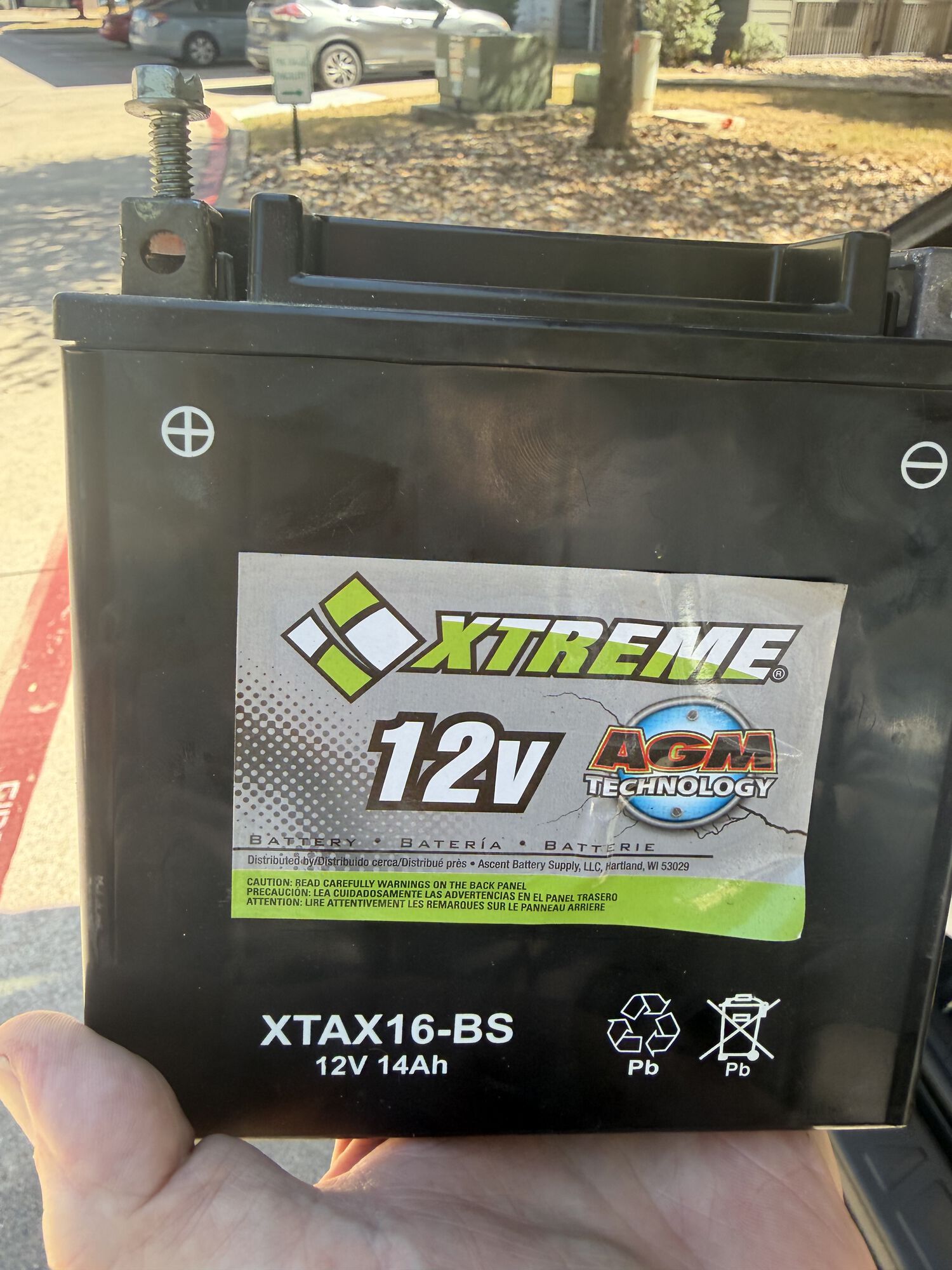

I removed the battery and charged it overnight.
Battery is done. No good
I bought it four years ago and it has been the best battery I have ever had.
No trickle charger and sometimes parked for two months of wintry weather. Started up every time.
I drove to Batteries Plus and replaced the battery with a new one just like it.
