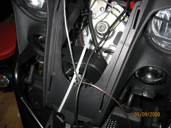

There are several places you can mount the Stebel, like here:
The horn is in there sideways, compressor is on the bottom.
