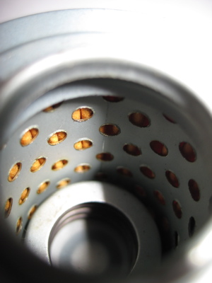

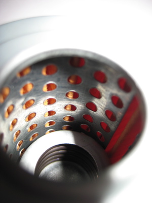

I had some of each type sitting around for checking the fit of the Snowflake wrenches so I decided to open them up and see what (if any) the difference was.
Here's what I found
1. can of piaggio seems thicker than the hiflo
2. there is paint overspary on the inside of the piaggio filter
3. The hiflo has 39 folds in the filter element to piaggio's 34
4. The springs that hold the filter in place are different
5. the bypass valve on the hiflo was stuck and has a much stiffer spring than the piaggio
some pros and cons for each but as long as you change them on schedule you're probably fine.

Piaggio inner mesh has more holes for flow but also has a gap in the mesh.
Hiflo has fewer holes in the inner mesh.

This is the second time I've read about a stuck bypass valve on a HiFlo. The other was claimed to be a problem. Opinions on his problem? (makes the Piaggio more attractive, What effect does the "gap in the mesh" have on filtering?

The force required to open the bypass (after it was unstuck) was ~40N for the piaggio and ~50N for the Hiflo. The Hiflo bypass was really really stuck and required at least twice that force to free it.
The gap in the mesh would have no effect on filtering but if the filter clogged then the element could collapse. But with a working bypass that's unlikely.

The reason the hiflo will have a slightly higher pressure release tension is due to the greater internal oil restriction in the filter cause by the fewer internal holes in the strengthening baffle, if they fitted the same strength as piaggios ones it would cause false openings.

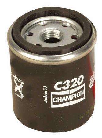

I just replaced the engine oil (1000km maintenance) on my new Vespa LX 125 :
The original filter was made by Sofima (no Piaggio logo on it at all) and I used a Champion C320 as replacement.
The Champion filter (made in EU) seemed to be better quality than the Hiflofiltro HF183 (made in Thailand).
