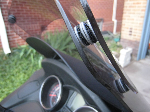

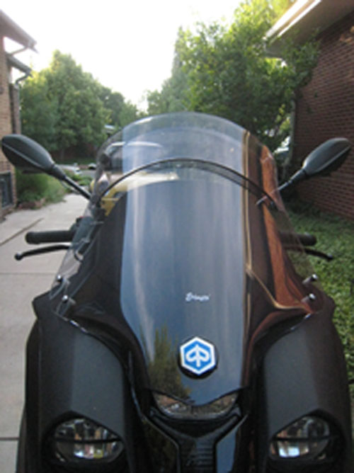

If you recall, I bought an Ermax screen, cut it way down, and have now
fashioned a laminar lip out of the discards. Since I had cut off the top, this
was fairly easy to do. I just cleaned it up, placed 3M Dual locks on it,
( I used two on top of each other to add more tilt at the top) and tried it in a couple positions. There was one surprise.
The photos show it in what seems to be the best position, and in that position, the air still hits you in the face, but it is much more defused, and
soft. From my experience, this is primarily the benefit you can expect from a lip. I have never experienced the " moving the air up 3 to 6 inches". But the air you do get is more tolerable.
The surprise was, I repositioned the lip so that it stuck up about 3 inchs above the actual screen, and at the same time that also re-positioned it
in a more vertical stance. Your intuition would say it should be even better. Not so.
The air then became almost intolerable. I stopped on my test ride, put it back the original way, and it was far better. Go figure.

That looks really nice. I haven't been too fond of the way windshields look on the 500 (reminds me of a dunkbilled dinosaur), but the proportions look great with your mods. I haven't been having problems with the wind, but I mostly keep her at 70 and under. This post has definitely got me interested in the possibility.

That looks the ideal placement for a 'lip'. It should move the 'buffet zone' up and away from the helmet - not providing still air. You need moving air to displace rain on the visor.

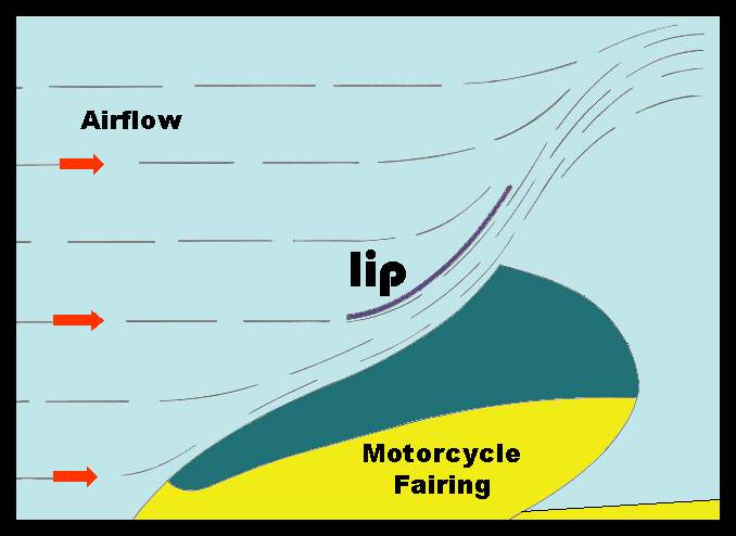

Re: Homemade Laminar Lip on 500ie
To get the air to move up you need a curve in the lip. More info here: http://www.laminarlip.com/howwork.php

The "lip" does have a bit of a upturn, though nothing radical. It is what
it is, since I can't actually make one I suppose. It works about as good however as the real one I had on my Scarabeo 500.
