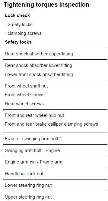

@paperino avatar
GTS 250 "Audrey"
Posts: 2117
Location: New Harbor, Maine
@paperino avatar
GTS 250 "Audrey"
Posts: 2117
Lock Down
Here's a snap from a GTS manual. There may be slight variations for other models, but this gives you an idea of what they're talking about.
