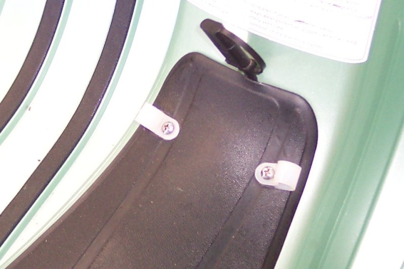

The dealer put some extra thing on the bottom that he said was for charging the battery without taking it out. Does anyone know what I am talking about? If so, what do I need to buy to just plug into the wall so the battery can be charged?
My "fix my bike" guy put the plug on mine so all I have to do is connect it when I pull in the garage and the battery stays charged, even in the winter (it does get cold in Pensacola). Mine is accessed by removing the pet carrier (under the seat) and there it is. I don't remember what he charged because he did some other stuff at the same time. But it's not expensive.
When he put that on there he should have given you the rest of the kit that plugs into the wall and connects to the trickle charge (which is what you have on there). Although my kit came with two wires for one plug and one is on my son's scooter. He will have to buy a new kit to use it. At least you have one already installed. Even if you have to buy another kit to "plug it in" it will be worth it.
Piaggio Typhoon

I talked to the dealer. He says they install these on every scooter they sell as a courtesy. All you have to do is buy a trickle charger and the battery is ready to go.
