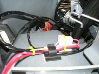

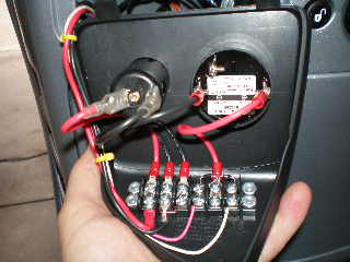

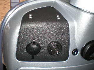

I installed a cigarette lighter plug in my left knee panel. I tapped into the alarm connector to get to 12V. All I have to do to connect the battery tender is to plug its output into the lighter plug. Couldn't be cleaner or easier.
I also wired a piezo buzzer into the turn signals, also available at the alarm connector.
BTW, I've never had a problem with the battery not holding a charge. I keep it on the tender as a precaution.
mating to the alarm connector

the guts mounted behind the knee panel
the finished product
