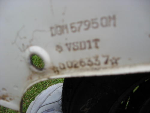

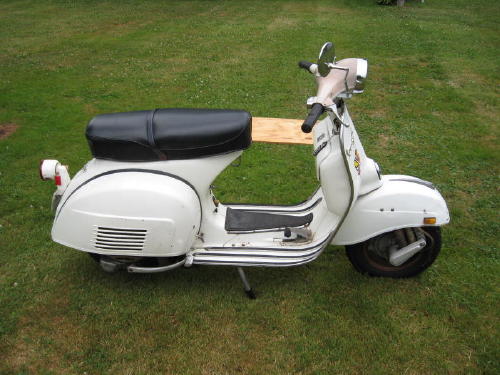

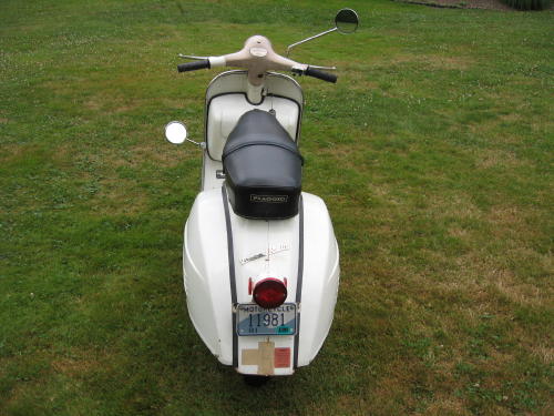

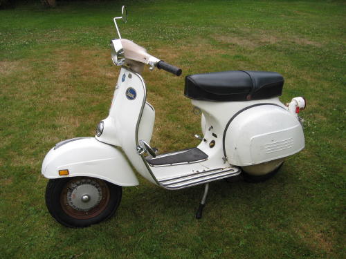

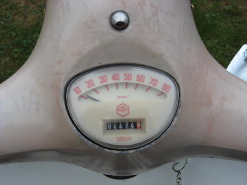

Back in May I decided to take this Vespa and try and get it running. I took it to someone in my area who does work on Vintage models since I have no mechanical skills. It was sitting in my shed for 15 Years and I had no I idea when the last time it was on the road before that. The shop I took it to has a good reputation plus he was pretty excited when he saw it. I told him I would just like to get it running and ride it this summer. I thought I would just clean it up the best I could and leave it as is buying just odds and ends that it may need ( rubber bits and pieces, mirrors etc.). The shop put new tires, took out and cleaned the gas tank, put an inline filter and checked ot the carb. Well to my surprise he did get it running. Thats great I thought until I had to register it. I had no paperwork on it. Nothing, Nada! Didn't realize it would be this hard to get something on the road. After about 2 weeks and some luck with connections I did get it registered and on the road only to have it stall out. Couldn't get it running! Well, I took the scooter back to the shop for more ajustment. I understood this may happen anyway since this scooter has not been running 15+ years. Yesterday I picked it up. They blew out the carb and changed the float needle and ajustments with the jets. It started at the shop. Got it home went for a ride and it stalled again. Not being able to start it again I walked it home. OK I"ve been beat up enough and sank enough money it to the scooter to want to sell it. Just want a Vespa to ride and be happy! Since the Man that owns the shop is very interested in adding it to his collection of Vespas can someone tell me what a fair price would be to sell it to him. I'll add some pics. Any help would be great. Sorry about the long SOB story. Just had to get it off my chest. Hopefully I'll be riding a Vespa 150 or 200 soon. Don from RI

You're giving up that easily? Come on .... It probably has a bad HT coil / or condensor. The original ones tend to heat up and fail after the bike is warmed up. A condensor is 5 bucks and an HT coil is 30-40.
That's a seriously classic bike you have there, and many people would consider themselves very lucky to have it. I beg you to have a little more patience with the thing. I understand how frustrating it is at first, particularly when you have no experience or troubleshooting skills for the thing ... but you gotta start somewhere.
I'll help you work through it, and you can ask all the questions you want, but i wouldn't sell that bike.
An original condition Rally 180 ...orginal paint, and that good a body shape? Probably $3000 at this point ...maybe $3500. If that bike were near me, i would have tripped over myself trying to buy it.
I really implore you to keep the thing, though. It's only going to get rarer and more valuable, and you've not even had a chance to enjoy it yet...

sorry, that was my jaw hitting the desk as the sight of such pristine paint! She's beautiful. Just a thought, but have you checked the condensors on it? If those are bad, replacing them should stop the stalling out. Dont give up just yet!
Frankly, i regret selling my '77 Rally 200, and she looked like yours does. But the scoot does have a good home now. I have an agreement with the current owner that I get first buying back rights if he ever wants to sell. And I'd pay up for $5k for that bike back in my hands...maybe more depending on my nostalgic feelings at the time.

That's a gorgeous bike and a model many folks dream of owning one day. Why is it so highly coveted? It's got a pretty reliable engine with good power like the later PX models but it still retains the vintage aesthetics of curvier, more voluptuous Vespas of the past. It's kind of a bridge between the more reliable bikes that came after it and the sexy as hell (but less reliable bikes) that came before it.
I'm sure if you get fed up with it there will be no shortage of people who will volunteer to find it a nice new home.
