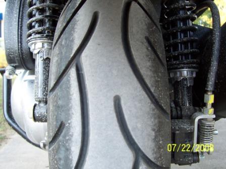

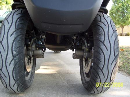

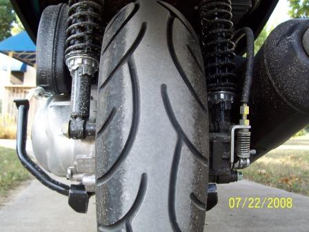

Here's the pics of my 250 Pirelli GPS 23 Tires (came w/bike). Just for reference if someone is looking for "Before" to "After" scenario!

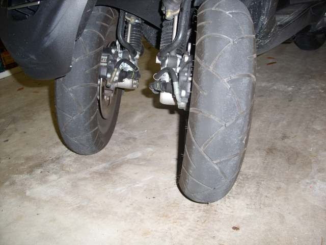

Fuzzy,
Do you still have that tire?

It appears to be a Michelin Pilot Sport SC.
I wonder if he still has it, and could slice it open in a couple of places to get some cross-sections -- first at the worn nylon belt, and second, at the "hole".

Left the old tire at the dealer when I got it changed. It was Pilot Sport OEM tire. I have cut a few to look at but didn't keep any. All had a fair amount of meat when the threads started to show but if you start wearing through the threads the strength is quickly gone. 100 miles prior to the picture there was no thread showing. Also ky in watching tire weaari they were thin at the very center but an inch away had a lot of rubberover the threads. This can fool you if the tread does not go to the center of the tire as the tread will look good but the smooth center is worn out.

Your points are legitimate. The tire that posted this thread surprised me as a newbie. I keep a close watc on my tires and it won't happen again. As to getting close to the end for me it is not a matter of money. Even riding them to the edge I was replacing tires in just 2 to 3 weeks of use. I had to take time off work and travel 40 miles one way to get them replaced.
As to the safety of running with low tread in the very middle of the tire it is not a clear hazard to me. Racing tires are slick. This is the current favorite tire on this forum and it has no tread at the center:
I personally prefer a tire with tread that crosses the center so I can properly judge tread wear at the high wear point of the tire.
