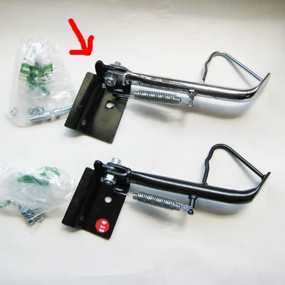

I know slight change of subject...
I have read from front to back here about sidestands...
I have an LX and I see this one from SCOOTERWORKS
The question is.........
The little lobe where the arrow is...
What if I grind a little off so the stand is pulled further foward and not so much perpendicular scoot?
I could also relocate/ add a new lobe if needed..
Think something like this would stop the automatic retraction?
@burgerbob avatar
SYM HD200, Vespa GT200
Posts: 1674
Location: San Jose, CA
@burgerbob avatar
Posts: 1674
Try checking this link:
https://modernvespa.com/forum/topic13094
Cheers,
Bob

I have one on my LX and love it !
