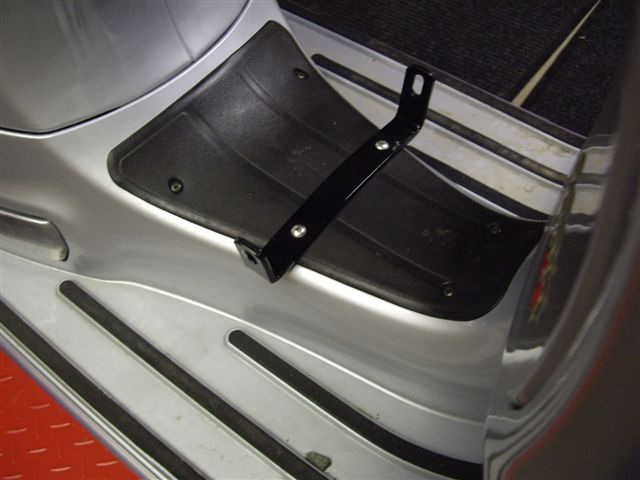

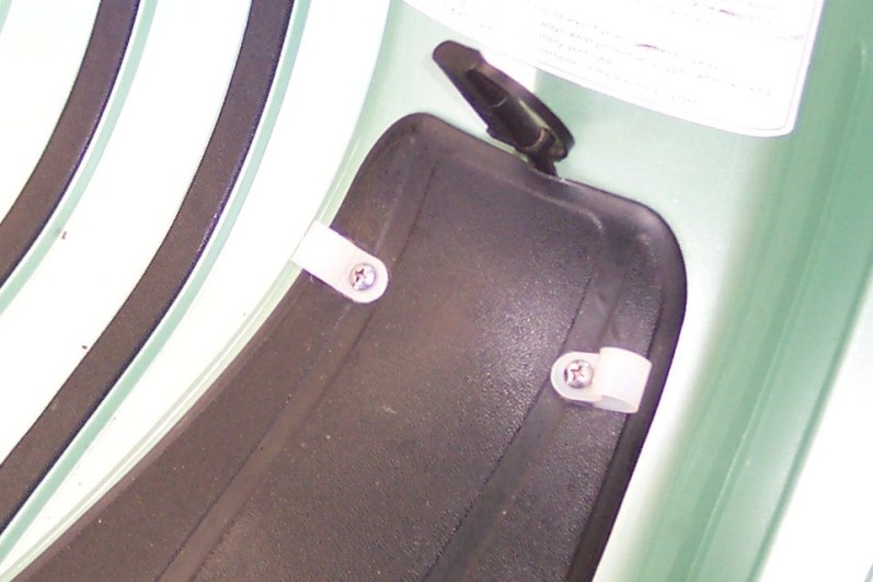

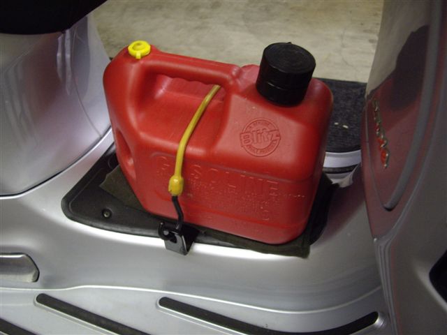

When I'm heading into unknown territory, especially deep into a rural area where fuel might be scarce, I carry a red plastic 1 gallon, 4-ounce container. It has a fill line for one gallon; the extra 4-ounce capacity is for expansion. I bungee it to nylon cable loops from Lowe's, using the four original screws in the battery cover on the floorboard. If you use a 2-gallon size, you can't open the pet carrier without removing the gas can.
The black thing sticking out from the top edge in the photo is a connection for my Battery Tender, Jr., if it's parked a long time during the Winter months.
