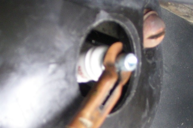

Got it started but only for a minute. spark plug comes out with some oil on it. Not black like burnt. here's a pic of the spark plug cable. Is this right? Seem like it doesn't have the greatest contact. Moves around so freely.
Again, this ran pretty great before I added more 2 cycle. I don't get it!

There should be a rubber boot over that (unless you pulled it back for the photo). Did you install a new plug?

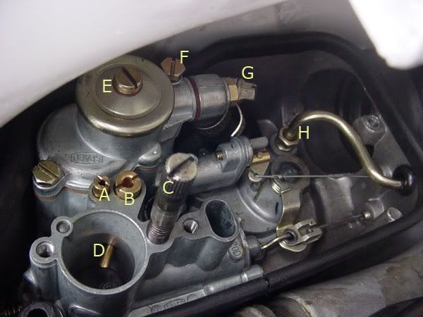

Do you know how to clean your jets? It sounds like your idle jet may be clogged.
Open your carb box. Unscrew A and B and clean them with some carb cleaner.
When's the last time you rebuilt the carb? It's really easy, only takes about an hour.

Also to clarify, cleaning those two jets will only take ten minutes and you won't need any new parts.
The rebuild will take longer.
