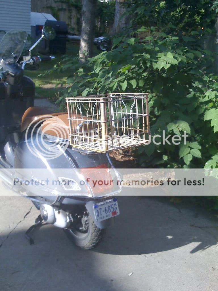

Quick update with a pic - love the crate, can haul things (beer) way easy - the look may not work for all - I'm not a top box fan.
