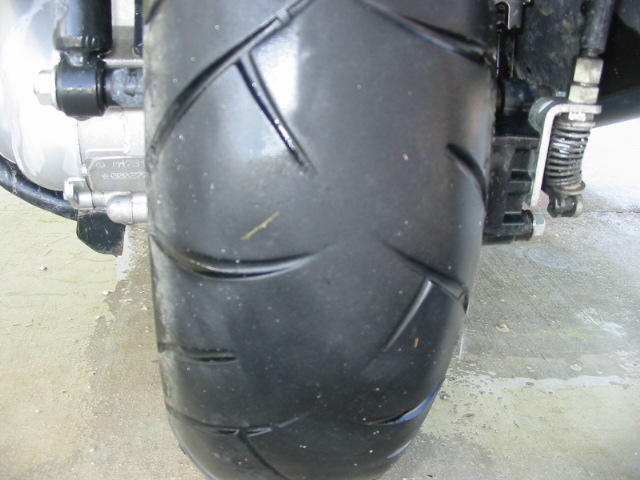

I've been experiencing some slight fish tailing the last few weeks, sort of feeling every crack on the road so I kept an eye on my rear tire. It's a Michelin, and this is how it looks after 3233 miles.
I can probably attribute the excesive wear to the previous flat I took due to a faulty valve cap, or to the poor road conditions on my way home.
Either way, I'm not pushing my luck so I am awaiting delivery of a new tire which has been ordered with the dealer.
Probably good for a few more miles but......

That's exactly how my rear tire looked at the same mileage. I would say that you got the exact mileage as is typical for a rear tire on an MP3 250. That's part of the reason why Piaggio went to a 14" rear tire on the 400/500, and why future 250's will probably have a 14" rear tire, too.

Rear tire wear
Looks to me like your wear is uneven on the michelin. Could be just the
photo angle. Maybe there is some adjustment to make on suspinsion.
The wear doesn't look to be centered. Kinda like my front pair ,ugh.

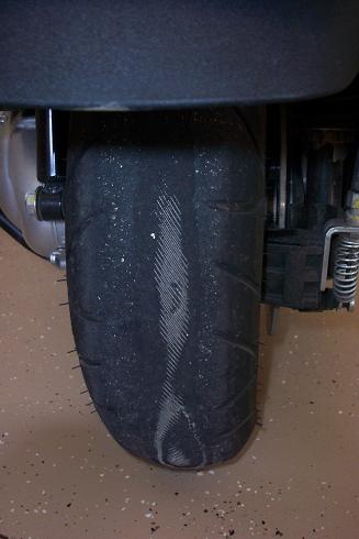

Here's my rear tire at 3189 miles
Don't feel bad, you know how I've been working on my bike, well, partly is because I'm waiting to tow its butt to a local shop for a new rear tire. Here's my rear tire at 3189: (and no I'm not riding it right now lol)

Glad you posted that picture of your tire Luthor, and it shows much more wear than mine. My wife thought I was doing wheelies and such while she wasn't around supervising me.

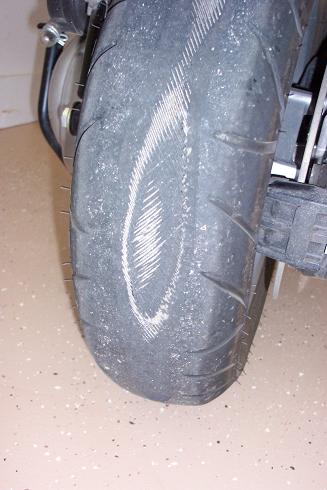

rear tire 3400 miles and almost gone
my MP3 rear tire with 3400 miles also looks like yours. So should I go whit the same type of tire? I guess I need to research more about it.

At the moment, I can't recall who it was that showed us his tire when it failed at 2900 miles, but his testimony was challenged because it seemed so out of the ordinary. The more he insisted that it was due to normal use, others would speculate that he must have done, or someone else had done, wheelies and such tactics which would cause the abnormal tire wear.
Then I started checking mine and posted my photo, which was followed by a photo from Luthorhus which had a worse tread wear. Now I'm seeing others with the same problem.
When Startrekstuntman had tire failure, Michelin and Piaggio were pointing the finger at each other leaving him with the cost of replacement.
As I mentioned many times before, I'm no expert on tires, or mechanical designs, but where there's smoke, there's fire. I urge you all to take a photo of your tire and note the miles somewhere for future pupose, if you feel that it is not holding its tread.
