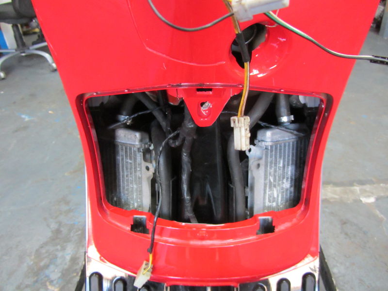

lx with radiators
lx with gt radiators fitted

Is there any space left for installing a radiator fan?

Only very small 12v computer fans
If there is a cycle salvage near you check out the fans from a Honda cbr1000.
Not sure what year those I found were.
They are very thin...<1".
That were the only fan found that would fit into a Skipper conversion I did in 2008. One also ended up in The 'ninja rabbit'.
Might be just what you need.
What are you doing for a reservoir/expansion tank?
R

hi, I am currently using the standard Gt water bottle on my conversion
Nice. I knew this was doable. Got pics of the holes in the legshield?
