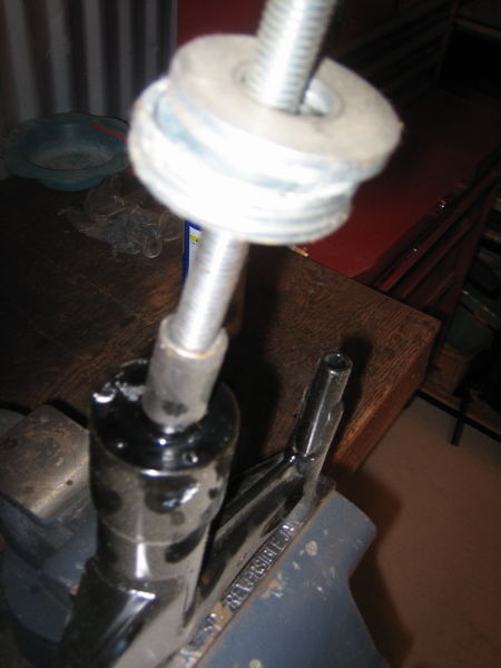

Step x Step ( with pics )
1. Obtain the following: Straight dental pick tool; 1/2"x 24" threaded rod and 3 bolts for the rod; four 3/4" washers; two 1/2" washers; two 1"x2" galvanized nipples from plumbing section; WD40; lithium grease or dish soap.
2. Put swingarm in a vise.
3. Use pick to separate bushing from swing arm enough to get a few drops of WD40 in there. do this in six or so locations around the bushing.
4. Use the 1/2" threaded rod inserted into the tube of the bushing as a lever and pry in a circular motion, working WD40 around. At the same time pull outward while circling and prying to pull bushing out.
5. Once one bushing is out, you can oil up the other socket and simply knock that bushing out with a drift. You will find a shim at the base of each bushing. If i was to do this again I would leave them out for the urethane bushings. I found they kept the inside ends of the tube from touching and thus requiring me to really pry the swingarm back into the frame.
6. Clean the penetrating oil from the swingarm and lightly grease the new bushings with lithium grease or dish soap.
7. Use treaded rod, washers, bolts and nipples as a tool to set the bushing back into the swingarm. In the photo I've improvised the nipples with a spark plug tool and a 1 1/4" nipple I had on hand. The idea is to press on the bushing and not the tube. The washers also help prevent the nipples from biting into the bushing
8. Tubes should touch each other, but I found the shims prevented them from touching with the urethane bushings thus making it a bitch to pry back into the frame. Like I said, I'd leave em out if I did it again.(and I would do it again, they work great!)
a few drops of WD40 in the socket
prying with 1/2" rod
working bushing out in circular motions
Bushing and shim
Bushing and shim
Rod through both bushings as a tool. note washers against bushing to protect it
Easy
Easy
Peasy
Peasy

WOW that is great, it is just what I needed to know THANKS!! I have a 7 inch long pick, that should work great for getting some WD-40 down next to the bushings. So I will work on that tomorrow.
I ordered a replacement swing arm bolt and nut from local Vespa dealer because the online supplier wanted almost $10 in shipping, that is more than the bolt and nut together...

I could not find my WD40 so tried soapy water and it worked just fine. I did use my ice pick to work the water down into the swing arm, and break loose the ruber from the inside. It walked right out of the swing arm with that circular motion just like you said.
I got a replacement front swing arm bold ordered, but it is going to be weeks. So I ground off the messed up threads and used my tap & Die set to cut new threads and got a new smaller bolt. I think I know now why the threads were messed up. It is tricky to get the bolt back in, lining it up through both bushing shafts without useing a hammer. The real fun was getting the back of the swing arm to line back up with the bushinged holes. As mine was over an inch infront of the holes. Ended up jacking the soot up with a floor jack then forcing the front wheel back down, that got the engine to swing forward enough to get screw drivers into the holes and swing arm so that I could pry it into place enough to slide the rear bolt through. Took lots of fiddling with to get things to line up right but She is all back together and took a quick run around the block. The poly bushing work great, the new tire felt odd but I only ran around the block. Now to wait for a dry day so I can safely wear off the preservatives and not have a slippery tire.

Just did mine.
Painless install thanks to the excellent tutorial by scootermarc.
A few notes:
1) Did not leave out the "shims" as suggested. Measured everything carefully and determined they are necesssary to center bushings in tube. Tight squeeze back into frame, but doable.
2) Inspect mount tube before pressing new bushes. Mine had excess weld that would have prevented install. Cleaned up with Dremel.

The 1/2 in. rod did not fit the old bushings or the new ones, the m12 rod that will support them in the swingarm fits like butter.
The 1/2 in. rod looks like it should fit, but I'm not going to force it. I'll just bring in a bushing and get the closest threaded rod that fits. I still need to put the new bushings in the arm.
Oh yeah, I need a spring puller.
Thank You Blue - I put nickles in the spring to get it off.
