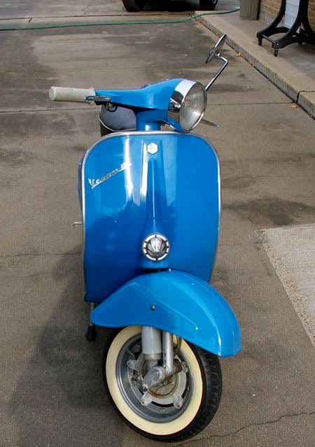

Worst news possible for my Primavera After a clutch rebuild, carb cleaning, etc. etc., and repeated attempts to adjust the idle the scoot still was having some issues. The good folks at Soho in Houston determined that the seals have dry rot. Grrrr. The great deal when I bought the scoot, has just become an OK deal.
Gonna call the shop back and see if I can come ride her around for an hour or two before they commence with the "open heart surgery".

Wow that is one awesome looking scoot. I hope to hear what becomes of all this!
