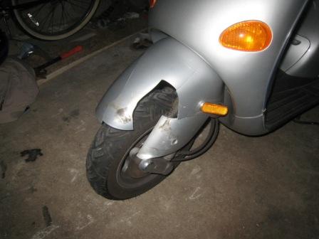

Man, I'm kicking myself over this one!
I'm normally so careful approaching intersections where the opposite direction is making left turns.
3 lane road...traffic stopped in the left 2 lanes so I move over into the right-most lane. For whatever reason, I didn't slow down approaching the intersection and a car came out of nowhere making a left, cutting me off. I wasn't going very fast but I did hit it.
Walked away and drove home with nothing but a jammed thumb.
Question is, what do I need to check out on my scoot? The front mudguard was destroyed but it seems to ride ok with no misalignment/warping of the tire. I rode home 10 miles and it seemed ok. Any suggestions? I'm wondering if all i need is a replacement of the mudguard.
Surprisingly, no apparent scratches on the body (the scooter as well as me). Relieved at being able to walk away...

Personally, if it were me, I would get a shop to check it over as soon as possible. I use my scoot for everyday transport, so I'd want to know immediately if anything was wrong, or had the potential to go wrong due to the hit. Like getting a delayed pain from a sprain, occasionally mechanical stuff doesn't immediately show a problem. Coulda knocked something slightly askew that you don't notice and you won't know it until it crosses a certain threshold.

I should get the front fork checked out. It can become bent with a collision of that sort.

Add the rim an the tyre to the check list.

with all that adrenalin rushing right after an accident it's hard to tell if your bike's wonkied. be careful.

If it was not your fault make sure you have your dealer check everything in the front you never know a month later you might find something and it will be to late.
