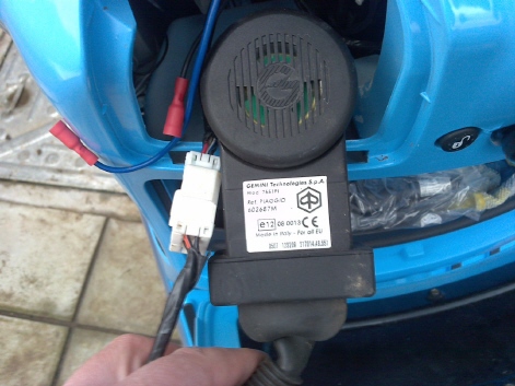

I recently purchased a Piaggio factory alarm, and searched the Forum for advice as to the best location to mount the main alarm unit (instructions are very vague). Best recommendation I could find was mounting to the horn post. Anyone have experience/luck with this or pictures of an install? Thanks in advance!

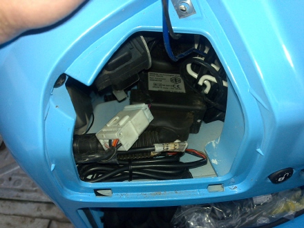

left hand black compartment ... tuck it in there with it facing forward .. and connect .. happy days safe bike

inside tou will find a spare white plug .. doing nothing .. thats the conection point .. give me five mins will take a photo of mine for you ok

it just tucks inside ..

keep it facing the front ..
