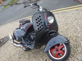

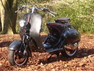

hello all, as i see alot of you guys n gals are not from around my kneck of the woods so i'd like to show you this latest creation of a 1952 vespa rod model auto conversion, comments GOOD, BAD OR UGLY are welcome cheers and safe riding
External inline image provided by member with no explanatory textExternal inline image provided by member with no explanatory text

cheers for the comments good and BAD, i know some of you will love it and some will hate it...i respect that, we're all individuals thats why the scooter scene is so great, why i did it...to be different, to ride it all over europe and not to be just an ornament like some custom scooters. if we were all the same it'd be one HELL of a boring scene ;D keep chopping and lets get rockin..!!!

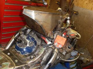

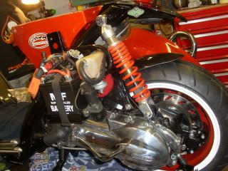

it has an italjet dragster water cooled engine fitted inside (as above) automatic, malossi 172cc barrel and head, 25mm dellorto open carb, malossi reed valve manifold,variator with pmt rollers, polini belt, gear kit and modifield scorpian exhaust, estimated to do 80mph +. vespa lx125 front forks, original mudguard suited to fit over 11" wheel, with original handlebars widened by 4". hand built subframe to carry rear end of vespa with panels fixed.twin petrol tanks which hold nearly 16ltrs.hand built seat with harley springs,aprillia radiator,bitubo rear suspension, 13" rear wheel,

we cut up and stripped the dragster because i was bored of it, (I KNOW WAT U MEAN ABOUT THE GILERA THO) you cant do alot to dragsters what other people have done already, as for the engine when i was running the engine about in the dragster it rode like a beast, even hairy arsed bikers were impressed Laughing emoticon Laughing emoticon some people may laugh or slag this quote off but i have touched the 90mph mark on the dragster, these engines are reaching over 100mph on race tracks,as for its proformance in this frame we'll have to see, im still running it in as ive rebuilt the engine. as for the question why a dragster engine....ITS LOUD, ITS SMOKES, IT SMELLS OF 2STROKE AND ITS FFFAAAASSSSTTTTTTT Laughing emoticon Laughing emoticon 8) what more do u want from a scooter i aint off to the shops on it Razz emoticon

I like the piercing on the legshield. I assume there's a radiator behind those holes?

hi, cheers, yeah the wheels were powder coated white then the red painted over the top with a thin charcoal greay pinstripe to seperate it, EVER LASTING WHITE WALLS Laughing emoticon Laughing emoticon
THE HOLES are cut using a special cutter (it also strenghtens the metal when cut) and theres a aprillia radiator behind covered by a tool box 8)

post more rear view engine side pics please!
