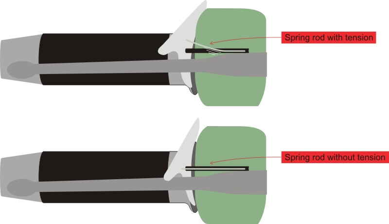

Here's a project I've started on. It's a cruise control that will work on the principle of friction. I have seen BurgerBob's and Moped's. Here's a more simple one. Check back for updates. Latest plans on top first, older ones below.
PLAN C - The Tent Stake- April 9, 2009
Building on Plan C, I happen to have a tent stake in my glove box and some rubber bands. Check out my setup. I tried it on the way home from work today. First impression: Having a sticky throttle feels sooo strange when it's engaged! It's like my Vespa has a mind of its own. We're all used to controlling the acceleration and deceleration with our right hand. We automatically know that once we relieve the tension our right hand has on the throttle, we know the Vespa will slow down. With the tent stake lodged in while in motion, it keeps going! It's such a strange feeling. At your own risk, you'll have to try it out see what I mean. Like I said, cruise control on 2 wheels isn't for everybody. I'd like to continue this project and get used having the Vespa continue to have an open throttle even though I take my right hand off of it.
The drawback to this setup is that the brakes will not disengage the device.
PLAN C - April 9, 2009
Here's Plan C that looks more promising. It's the same wedge concept. The first picture shows a disengaged wedge where there's a piece of um...'stopper' that prevents the wedge from lodging itself in between the kill switch housing and the throttle. The 2nd picture shows the wedge engaged. That is when the throttle has been twisted back, making the 'stopper' twist back with the throttle of course, giving space for the wedge. It can be disengaged by squeezing the brakes, or by rolling the throttle forward. The 'stopper' will release the wedge.
PLAN B - April 9, 2009
Here's another idea. I can see a few design flaws already, like the part where the brake lever pushes the wedgie back, what if it doesn't catch on, or what if the entire thing bends? Flaws. But this is just to give you an idea of my Plan B. Here it is unengaged. Press with your thumb to wedge to engage, and (for now) squeeze the brake lever to disengage.
PLAN A - April 7, 2009
Here is the paper model. I'm going to use it as outline on a piece of plastic as thick as the space between the watchamacalit and the throttle.
Engaged.
Disengaged when the brake lever is squeezed. Notice there is a little curve on the front to disengage it with your thumb without having to squeeze the brake lever.
More on this later... Your thoughts please. Tips, pointers, flaws, drawbacks, improvements -- all are welcomed.

looks brilliant. What material are you gonna use? I'll take one....
I will be using some type of (not so brittle) plastic, like the same material used on large paint buckets. Easy to cut. I have a Dremel. I've got one laying around. I don't know yet. Got any ideas?

Interesting idea, Rex. My first question, where are you going to mount the spring to hold it against the throttle grip? Then, how is the release mechanism going to work? Where did you attach that pivot bolt? I know for a fact that a fair amount of pressure is required to stop the throttle from turning. You may need a rubber edge to the plastic unit. I think that the biggest problem to your design is how to engage/disengage the spring mechanism. Nice idea though!
Cheers,
Bob
Cheers,
Bob
Great questions. The spring thing is the challenge. I have an idea, in theory. I won't get around to installing it until I get the plastic wedgie thingy done. I'll call the wedgie thing, "The Wasp" since it (kinda) looks like a wasp in flight.
