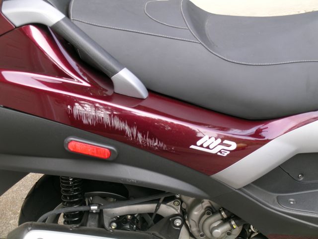

I'm a scooter noob and just bought a 2007 cherry red 250ie with 219 miles on it for $4400. It was tipped in the driveway by the previous owner and is a bit scratched. Think I can buff it out (if so, with what) or should I just get the panel replaced?

replacing the panel will be expensive, but the scratches look too deep to buff out...
i would get a vinyl graphic you like to place over it...10 to 20 bucks could get you a kick ass graphic...

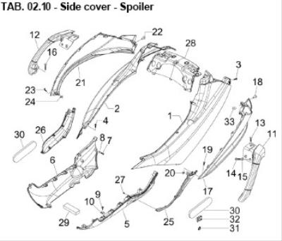

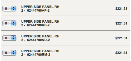

According to Athens Scooter, the part is $221.31 for part #2 (that is if i did my research correctly). Does that seem accurate? I'm not sure if it's part #2 or #21 that I should be looking at on the diagram...

You can't buff that out. Those scratches are through the clear, color, primer and into plastic it looks like. Replace panel, cover with graphics, or see if a local body shop will color match paint it.

Or you can sand it and paint it with the original Piaggio dark cherry spray paint. I just happen to have two cans which I will be happy to sell you for what I paid for them.
I had to order them from the Netherlands to paint scrapes similar to yours but, before I could get to it, the bike got damaged far beyond what paint could fix.
Let me know if you are interested (You can PM me) and I'll find my receipt.

vinyl graphics or get the 2 cans of paint from mpfrank. it ain't bad enough to spend $200 + on a NEW panel.

BTW...welcome to our forum macaid! Love that color MP! As far as your boo-boos, I'd buy the paint from mpfrank....you can always change-out the panel or cover it with Ca.....RaZy graphics

After sanding, what kind of light bondo type filler and primer should I use prior to spray paining?

You should check with an auto paint supply store. Since it is plastic the filler, primer, and paint should be for a flexible application. I say 'should', you might get by without, but up to you what corners your happy with cutting. Otherwise any department store with an auto section should have what you need.

I would't worry about the flex agent on a side panel. Not enough "flex" to worry about. Sand with 220 and a SMALL amount of filler. When filler is set, sand with 220, 320, 400, wipe, prime, then paint. The ony time you need flex agent is when you paint a panel that moves alot.

Try the paint FIRST, you may have a talent to take care of these scratches. Then you can use the newly discovered talent for the rest of your life on the rest of the scratches you will acquire.
Now, if it doesnt work out, or if you dont like the way it comes out, just go ahead and buy the panel.
Remember, always try the cheapest route first.
OK, I have time to tackle is project this weekend so here is my plan if I understand everyone correctly:
1. throw tarp over scooter in driveway and cut hole in tarp to isolate damaged area on side panel then secure tarp to scoot with with painters tape
2. apply small amount of filler and wait for filler to set
3. sand with 220, 320, 400
4. wipe, prime, spray paint
Sound good? I will take photos of the repair just for kicks. What brand filler and primer do people recommend? How long do i have to wait for filler to set? How long do I have to wait for paint to dry?

You left out step 1a.
Sand the scratches FIRST, then use filler.
Those scratches will most likel have curled up some plastic above the surface of the panel. Using filler with those raised surfaces will mean that your filled area will now be as high as any burrs.
