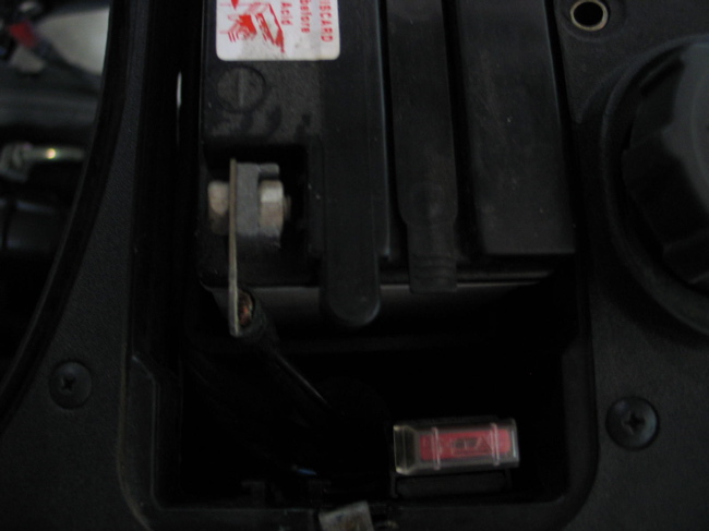

Lu wrote:
jimc wrote:
Check the main 10A fuse.
Where do I find that?
Mate it's the red fuse next to the battery.
Cheers
10 Amp Fuse (Bottom right)
