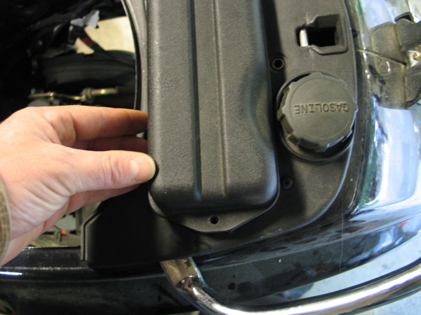

Hi Mate, Your battery is located near your seat latch.
Remove the phillips screw and you are in
Cheers
Open and your in

but how do I get it out?...aren't there cords attached? why am i so dense!??!
No mate not dense.
You will need your phillips screw driver. There is one in your small factory tool kit (Black plastic bag) Should be under your seat.
Cheers
Posts: 45942
Posts: 45942
Undo the black wire first. Undo the red wire. Lift battery out. (Sheesh!!!!!).
ROFL emoticon not dense.... there's a first time for everything. just disconnect the wires, then reach in and grab the battery. there aren't any cords to lift it out with.
