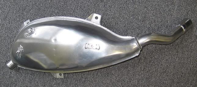

I had a PM pipe on my ET4 for 5 years 36000km and it never had an issue and the product was very good . I did initially have to modifie it slightly to make it fit nicely at the head. I am not a fan of performance exhaust anymore, the noise gets to me. I know you don't want to hear it but I would say my initial response would be go back to stock but I won't cause I don't want you yelling at me. My PM pipe was mounted on a floating system that had give. I was wondering if you used a hanger type device that had a rubber bushing to allow for some movement, perhaps this would help stop the stress from building up. I don't know, but I suspect this LV is hard mounted for it to be breaking the header like this.
