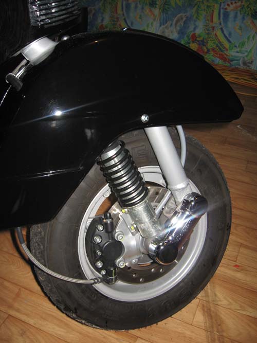

disc front
looks like new fangled thingamejig
