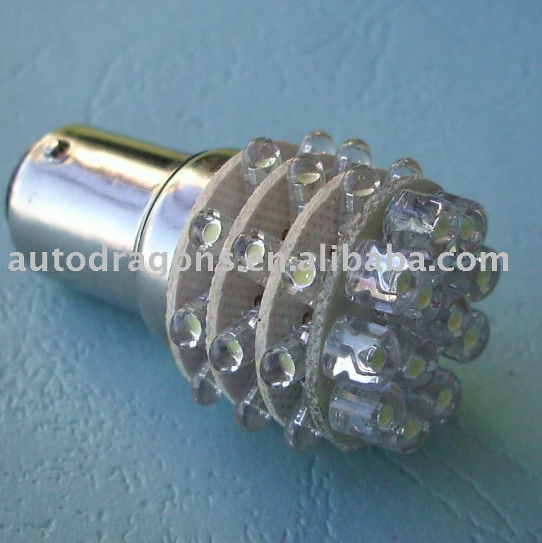

Corsader,
Are the ones below available but to costly or are they just not available? Just curious,since these pretty much duplicate the 360 around stock bulbs. No doubt they would work as far as the way their built.Just imagine the intensity.
Thanks Corsader

These bulbs that Scootover posted here might be the ticket. wouldn't cost much and my curiosity still has the best of me.
