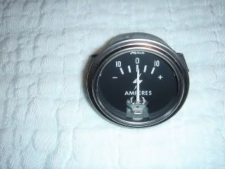

Although a voltmeter is helpful, you may want to consider the amp meter as well.
The amp meter is a great instrument that indicates the condition of a scooter's electrical system.
An Amp Meter will fully indicating charging and discharging currents.
Actually, both a volt and amp meter would be the best of both worlds.
Amp meters were once on cars, trucks, farm tractors and most every engine with a charging system.
But, I never saw them on any scooter.
Meters were replaced with idiot lights since some people didn't understand what they were
indicating and paid little to no attention to them anyway.
Now we don't even have idiot lights.
Now it's the "check engine" light/alarm.
I once had a car that had both idiot lights and meters for oil pressure, charging current,
and coolant temperature.
I guess it worked for idiots and informed folks alike.
I have an Amp meter ready to install on my ET4 but haven't made or purchased a current shunt yet.
I will post as soon as I have it completed.
But I would really like both volt & amp meters onboard.
Since battery life seems to be a real issue with scooters, meters could be used as an early
warning of impeding battery death and charging circuit failure.
