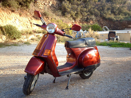

1990 Late Mk1 Cosa. pre-modern iteration of the P-series
Pros - Useful daily ride with plenty of storage space.
