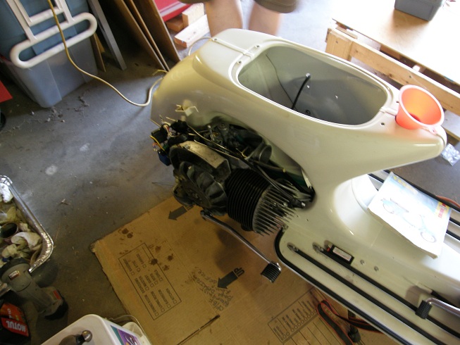

Location: Orange County
Update on project Sportique Aug 29
Today we installed the P200 engine that I purchased a year ago and was rebuilted by the previous owner. We only hooked up the CDI and it fired up in three kicks. We also replace the oil seal (simple) and installed the muffler
Picture from video of engine running after one year hiatus
Pic of engine installed

Thanks. Good eye....no it can be removed as I will most likely just sand off the rust and paint it. I am really not into the chrome...too much polishing required

HI JAXS
I must inform you THAT YOU GO WHERE THE RUBBER MOUNT GAS PIPE ON THE CONTRARY
@laclinica1 avatar
many
Posts: 78
Location: Cordovado-Italia
@laclinica1 avatar
many
Posts: 78
CORRECT

Got it and thank you for the information & picture

So on Friday, we managed to get the headset on and do some of the rigging before flying off to Vegas to visit our other friend.
I also managed to get a 1962 VBB engine from Bob at Moto Paradiso in Santa Barbara this week...thanks again Bob. Its in good condition (minus some chips on the stator side which shouldn't matter) so I will replace the P200 engine in the Sportique with this one in the future.
Today, I picked up some parts for the VBB engine at the Scooter Shop in Orange...thanks Mic, Jeff, David and Hector. We should only need one more day to complete the Sportique then it will be the Rally 200 engine rebuild.

Finally finished....well sort of ????
So today I managed to finish the 1965 Sportique and I must say it was frustrating, time consuming but well worth it. I rode it down the block a couple of times and its faster than my P200 maybe toooo fast as it has the notorious front fork dive. The front GS150 10" wheel rides fine with plenty of clearance.
So you can see in the pics the cowls are not installed nor the headlamp. I found a 1962 VBB engine so I am going to rebuilt it and use this engine as I have been told the kick start lever of the P200 engine will hit the cowls. The headlamp I have is a reproduction that did not fit properly so I either have to find a new bezel or another headlamp with a pilot light. Also the seat pin is the wrong size plus I found some nice SIP VBB foot rail that I will most likely have installed at the body shop. I added some minor scrapes here and there on the frame. In talking to Hector and David, I might also return to the original 8" wheels to keep the Sportique authentic plus my girlfriend (she's 5') wants it.
So I still have 3-4 more Vespa projects left and still looking for a SS180.
Thank you all for the advice and feedback
