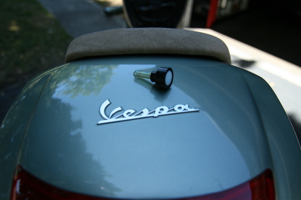

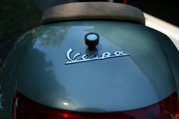

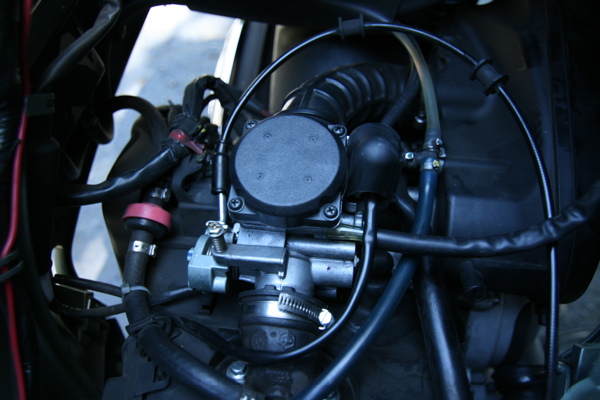

The finished product - hose & filter in place
The filter and hose on my topcase for reference
The filter itself
The filter itself

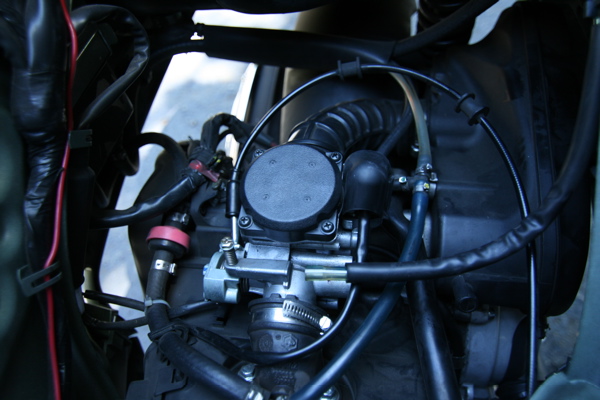

The EVAP hose is now disconnected

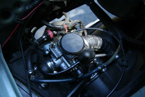

Everything connected as it comes from the factory
