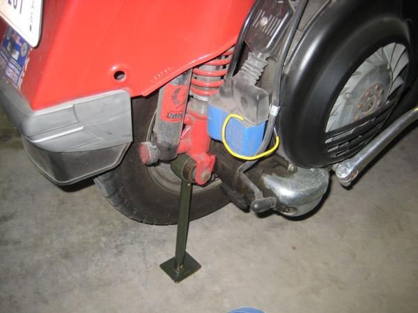

So my New Rear Tire Jack came in the mail today.
The new Jack is great.
I thought it would take two people to put it
up on the Jack, but it was very easy for one person.
This jack can even fit in my glove box.

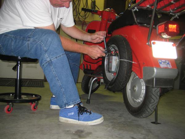

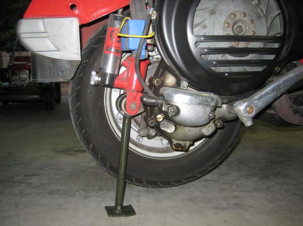

do you put put the center stands down first, then life the back and put the jack under the engine case?
Yes.
I put a 2 by 4 under the stand feet and it worked perfectly.
I can't say anything other than WOW, it's a great tool.
I have changed many rear tires, and this was the easiest of all.
You just need to let all(or most) of the air out before
you take the tire off the scooter.
For the $25.00(including shipping) it's well worth it.
It's smaller than you may think, fits in the glove box.
Don't know if I would try this, maybe using a coconut juice can.
This is much more stable
I got mine from here
http://www.clevelandscooters.com/catalog/i125.html
Rob

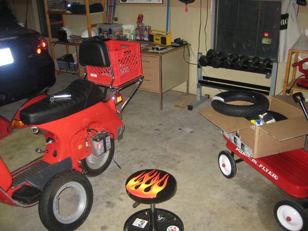

Great Minds...and all that crap. Got my Shipment from Motorsport / Scooterwest today; 30% Off @ Free Shipping...Love those guys.

Your shop looks a lot cleaner than mine 8)
Rob

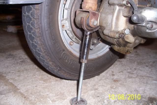

here's mine... small, compact and easy to put in...
no need energy to lift your vespa and fit in my glovebox Razz emoticon
External inline image provided by member with no explanatory text External inline image provided by member with no explanatory text External inline image provided by member with no explanatory text
Sweeetttt!!! where can i find it????

from what I've seen is
there is space between the front wheel and ground
the jack uses that space so the bike has 4 points of contact
jack-front-two stand legs
Yes, and I also put a piece of wood under the center stand
and the front wheel is off the ground. It really
only takes one person, and it was not awkward.
Rob
well... that's oldstuff and I found it on flea market at poncol...
might be you can find similar like that at kawan lama
Rob
Hey Rob thanks for the pics. I'm new and didn't how to use it.
Thanks!

To put it on the stand with one person:
Leave scooter on center stand (or without, depending on whether you are coordinated and/or strong)
Put jack on shock mount
Put foot on jack
Press with foot while pulling scooter back (grabbing at the front of the seat).
Voila.
You can do it without the centerstand if you have a sidestand but you have to be coordinated enough to balance the scoot with one hand while positioning the jack.
On that point - I hate the damned things. On the road I just find a brick or something, or lay it down, but with an expansion chamber I gots to remove the exhaust to change the tire anyway, esp since I am running a 130 rear tire.
I know that I probably posted this on another
thread, but I've used this jack on the road,
and it was really helpful. I'm not sure were you live,
but it's not always that easy to find bricks laying around.
This jack is small enough to fit easily on the scooter.
I know That some people can also use a
high curb to change their back tire.
But, if I don't have to push it(does not roll at all), or look for
a brick (when I almost killed myself on
my scoot when the back tire blew out)
it's nice to be carrying the solution.
I don't care if it's not an original Piaggio part.
Rob

I saw the OP's jack a couple of years ago that gave me the idea for this:
It's made of these pieces. Fender washer with welded on nut. 5/16" threaded rod. Wrist pin with welded on flat stock curved piece.
The first pic was a quicky. I normally place it straight up or tilted slightly back to help keep the center stand locked. Turn the nut under the shiny piece to raise.
Threaded rod - 6.5" long
Wrist pin (pipe) 3" long.
No flats yet, but I have used it four times for practice. On a P, leave it in neutral, hold your mouth just right, pull down and turn the hub and the wheel and when the planets align, the wheel comes off. That pesky plastic/rubber bumper is aggravating. The jack fits easily in my tool pouch.
