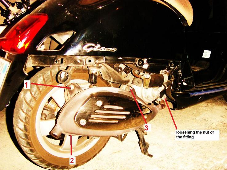

hey guys,
Yesterday i changed my rear wheel on my GTS. I decided to explain, for novices, how to remove rear wheel on this ride.
(Sorry for my poor english. I hope it will help u)
See you
Remove turn light, in order to unscrew nut of lateral stripe.
remove screws to pull off the pipe

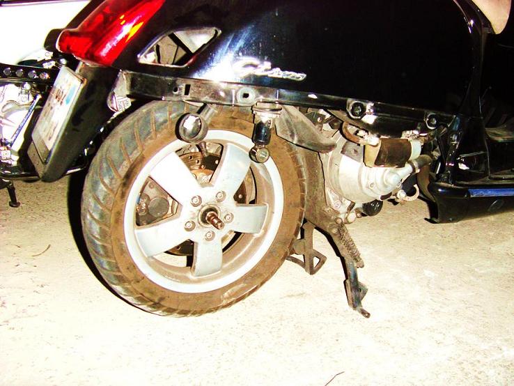

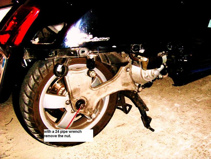

remove screws
remove screws
If you don't have any impact wrench, just brake!

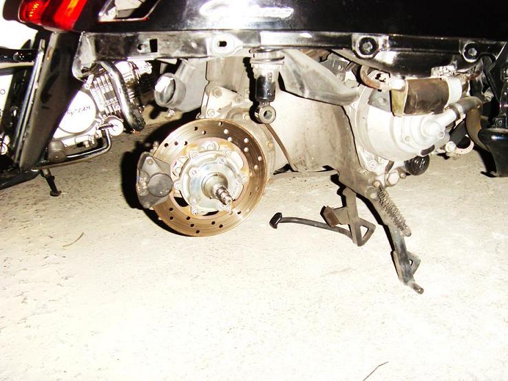

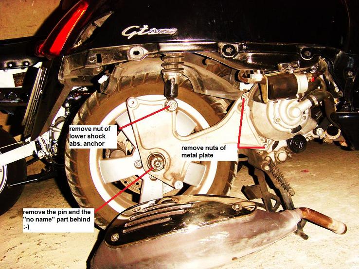

Just pull the metal plate.
Sometimes, ball bearing is griped on drive shaft. In this way, you'll have to remove it with an hammer.
At reassembly, don't forget to lub it with a good grease (Teflon, graphite...)
Just pull the metal plate. Sometimes, ball bearing is griped on drive shaft. In this way, you'll have to remove it with an hammer. At reassembly, don't forget to lub it with a good grease (Teflon, graphite...)
It's over
It's over

You do not have to remove the tail light to get to that nut. Just lay on your back and reach up from underneath. There is plenty of room to reach it with a socket and get it loose then just finish taking it off with your fingers. It is a lot easier than taking out the rear turn signal.
Have you downloaded the Parts and workshop manual for the GTS 250 from the Wiki site here?? They will give you the names for the "no name" parts you pointed out. 8)

Great write-up! If I may add, the "no-name part" is just a small spacer.

its called a Castellated Nut Cover

I thought he was refering to the cover over the nut...
Also, when I removed the rear wheel, I didnt' have to remove the turnsignal or the lower trim panel. Is it easier to get to some bolts this way?

you guys are right about the castellated nut cap. For some reason, on my first read through, I thought he was referring to the spacer behind the nut.
As far as the turn signal goes, it may be easier to remove it the first time just to see the fairing nut better, but I've always just done it by feel.
