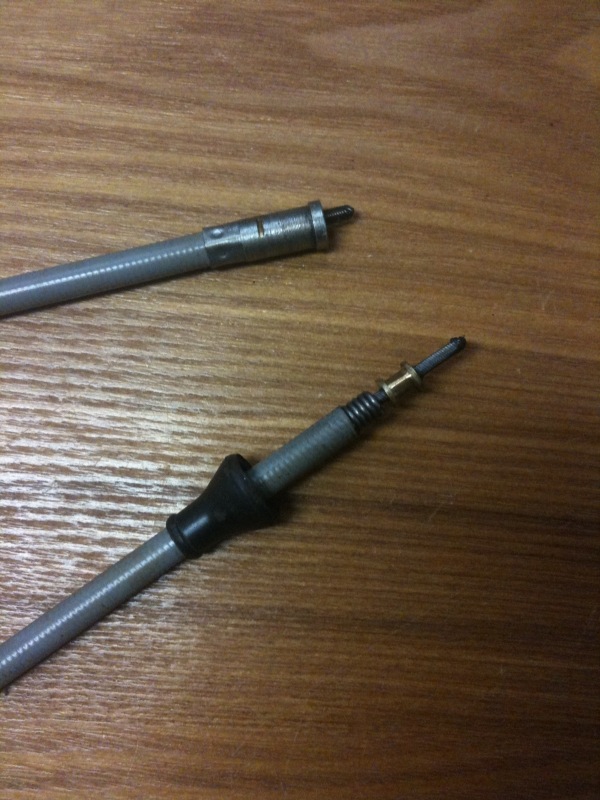

Well, the previous owner dropped off what he says was the speedo cable, however I think it's missing something, like what secures it in down by the wheel, etc. Can anyone tell me what's missing?

the end in the upper half of the picture is the part that plugs into your speedo. There's ( on this bike, i believe ) a white plastic bit that has two prongs on it that goes around the outside of the cable and snaps into the speedo to hold it in place.
the lower half..it's hard to say and depends on the bike.
Some bikes have a small, knurled ferrule that kinda grips onto the outer using the little bronze bit you have present... and screws into the speedo drive assembly on the fork... effectively holding the inner / outer in place through pressure.
Some other bikes like smallframes have a rubber bung that goes on, and that's held in place through a little plate that bolts to the wheel.
also, the cable inner you're looking at is threaded backwards. the end with the brass bit stuck to it goes at the TOP.
As i go back up and look at the pictures, i guess yours is held in place down at the wheel by the rubber boot you're looking at, which creates enough friction that it holds it in place. The boot snaps over the lip on that white square piece.

I have to go into Fremont today so I'll check with Sound Speed Scooters and see if they have the plastic bit I'm missing that connects the top part to the speedo, I have a feeling it went AWOL in the guy's tool box where he was storing the cable.

the part i think you need is pictured in the inset of the picture below. I could be wrong ..but i'm pretty sure i'm right. Bajaj did all sorts of wonky non standard stuff to their bikes. I know how the italians did stuff... and not so much about how the indians knocked it off and tweaked it.

On the Bajaj I had it didn't have a plastic piece. It actually did have the metal ring at the top, it was just hella bigger than any Vespa part. Looks like your speedo is threaded where the cable connects? So I'm guessing it also had that type of ring.
In the absence of the proper ring I wonder if you could rig something up with some washers and a jam nut (thin).
<edit>Actually, now that I think about it, this wouldn't quite work because the threads need to preceed the washer. Maybe you could find the right size threaded nut and then weld a washer to the back of it to catch the lip of the cable housing. Or seriously just electrical tape it up there and see how it holds</edit>
Again, just guessing for your specific bike and attempting to share my experience with a similar Bajaj.

Yeah the bottom is threaded, the boot i have on the cable was laying loose in the headset. I just tried putting it on in a multitude of ways and it looks like it's about 2 inches longer than it should be which is causing stress on a couple points and making it pop out because I don't have the threaded nut.
Looks like I might have to spend some time fabricating something.
