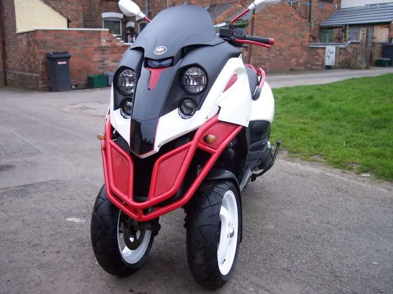

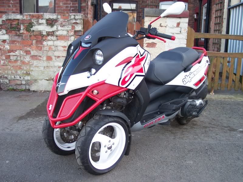

fitted these a while ago
they dont stick out as much as the others
and are loads brighter

buddyphil nice lookin scoot you have there. the turn signals are small and out of the way. can you post a pic of them lit in the daylight and at night. also what breand are they and model number. thanks OAD
Hey Buddyphil, where did you buy the rims en what are the partnumbers and price?
thanks.
