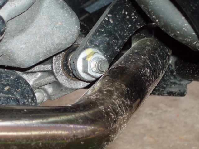

I put the Prima on my gt200. The muffler will be under waranty, I asked my local vespa shop and they said as long as it has nothing to do with the exhaust system it will be covered. For example, if something happens to your front fork or brakes, then that would be covered. If you start having fuel problems (you do have to upjet with the new exhaust) then that would not be, becuase someone has messed with the carb. I love my new exhaust, the only bad thing about it I have to say is clearance, and the clamp. The clamp that it comes with is pretty flimsy, get a better one, I still have not been able to get more than about 1/4" of clearance between the head pipe and the swing arm. I hit a large pothole, and snapped it once. They replaced it, but now I have to ride gently, very gently. good luck, I will try to post a pic soon of the additional clamp my mechanic came up with.

pics of mine
bnot sure what you mean about gettin the old exhaust off. just the bolts on the swing arm and at the exhaust port need to come off. here are some pics of the additional clamp my mechanic rigged up. Its the on towards the front. There is also a pic of the clearance issue I had mentioned. Not sure if the design is a lot different for the 300, but you may have the same problem.
