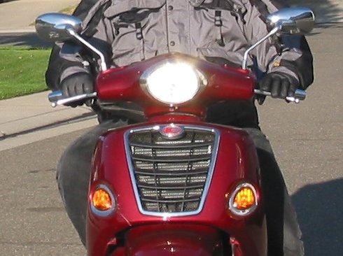

Let's the pictures do the talking now:
In the beginning, there was chaos. This is the Hoppy with the full wiring. Most of that will go as it is not needed.
The input side is the one with five wires (on the right). See diagram for details.
This is how I integrated the two load resistors. They are necessary to prevent the blinker to go into fast mode, thinking there is a blown bulb. Note that the ground connection goes to the white (ground) wire on the output side for streamlined wiring. The connections are made with splicer taps.
The connections of the input side: all are tapping into the shown alarm connector.
Because I already had some wires going in, I spliced directly into the wires for ground and +12V. The two TSL contacts (yellow and green) are going into the connector (soldered ends).
This is how I wired it. You will see that for output, I only need two wires, yellow and green, and I crimp-connected those to the wires going to the TSL. Note that the (black) ground wires remain untouched, and the + wires for TSL need to be cut and not reconnected.
Ta-Daa! Running lights always on, and the TS switch will determine which of the two will go into pulse mode, to indicate your turn. I trust that this solution is bright enough (10W) to be seen at daylight, and the way I exposed this picture proves that point.
FTR, the center horn cast light is a 5 SMD-LED lamp (bluish white)
For tools, I used the obvious (whomever will attempt this project will know what they need), but I want to point out that I also needed a fly squatter. Pesky, pesky, pesky, and not good when you're leaning into the scoot, juggling wires and electricity

I like it, a lot. Can you tell me something, the indicator light that you activate, does it blink brighter or just go off and on while the other one stays on?

It just goes off and on, not brighter. That would require a two-filament bulb which was act one or two, I forget.
The way it is now, it is quite conspicuous, at day and at night (as I found out when I closed the garage )

Excellent outcome and solution. That is a mod that I would consider for the future on my Super. 8)

This is what I used for my front and rear running lights. They are sufficient lighting.
http://www.superbrightleds.com/specs/WLED-xHP5.htm

To answer a few questions that came up:
I did not test what the rear lights would do without splitting the front lights' wiring. Looking at the electrical diagram, they might be connected. I would not want all that amperage being drawn constantly, though, and the rear running lights are not necessary, IMHO, to increase safety. The front ones may actually help.
As you can tell, I'm not so much for looks, more for function. YMMV.
For LEDs, I used that WLED XHP5 bulb. It would only give a decent light output forward when I pulled the lamp holder almost completely out of its socket. Since that is soft plastic and is tight enough, I hope it will hold. Pushed all the way in, as it is supposed to be, the light output sucks.
Also, keep in mind, these LED bulbs are quite expensive. Two of them (amber ones) died right away and I had to return them (got a refund).
