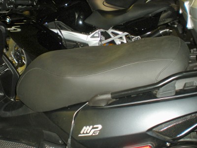

...and here are a couple of photos of the seat as requested. It sits quite a bit taller than stock. It was designed for me and my 6'4" frame.

Seat looks comfy, how much did you raise it?

Sorry, I don't know. I didn't take before and after measurements. Don just builds the seat to fit the rider.
