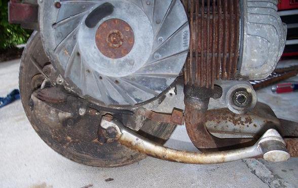

Now, for actual progress! We got down to work over the long Labor Day weekend, and got quite a bit of disassembly done. We discovered plenty more rust, but were able to get through most of it. It didn't take long for us to get pretty serious though, and by the end of the day were having to cut out bolts that were free of the frame, but had rusted to their nuts and refused to do let go. The main goal for the weekend was to disassemble the engine and see what we had to work with, and what needed to be replaced, but we didn't get as fas as we'd have liked. The piston is currently locked in the cylinder head, blocking us from removing much else, so we moved on to the front end. When we started, both the clutch and accelerator were frozen, as well as all the electrical switches and the clutch lever. The only reason the brake lever moved was because the cable had obviously broken somewhere. We got everything free except the clutch handle won't turn freely. Hopefully I'll have more soon!
PS The plastic bucket with the white lid that I just realized shows up in so many pictures is where we're collecting all the small pieces and parts until we can clean everything up and see what we can reuse. Gotta stay organized. Everything from screws to bearings to the speedo are in there!
She takes up a bit more room now that she's disassembled.

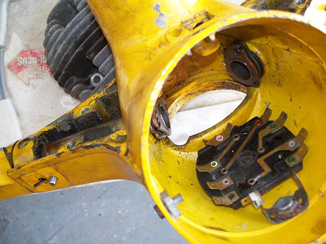

More inside the headset. All the electrical contacts and things here look clean, but that clutch side just won't turn.
Can't wait to be rid of this.

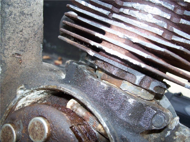

Our first major concern. That's some magic spray dad has the cylinder soaking in to try and break up some of the rust. She's totally frozen. We're crossing our fingers that when this is free everything else will come loose as well though. Right now kickst

Well, my project is officially toast. We bought this thing with a questionable...well, everything, because we thought the engine would be workable, that we could rebuild all of the mechanicals, and then worry about the pretty stuff later. Taking this idea to heart, Dad and I went to work this morning to get the engine apart.
As I mentioned last time, the piston was stuck pretty well in the cylinder. We had no idea how well. After soaking in PBBlaster for three weeks, not a drop had sunk in. We pried, wedged and gently hammered until we knew it wasn't going anywhere. We finally decided that both the cylinder and piston were no good, so we got more forceful. We prying to the point where we were breaking fins off the cylinder. No good. We started hammering to the point where we broke off the rest of the fins. Didn't move an inch. We finally got results when I pried with dad's 2ft+ long, half inch thick flathead screwdriver (which he calls the Volkswagen attitude adjuster...apparently a necessary tool for working on VW's) and he hammered directly on the piston. Things started to move, but we realized after got around an inch and a half of clearance that the piston still had not moved. We'd either something had come loose, or we'd bent the piston arm. The latter seemed more likely.
At this point, we looked at our parts manual and got a great idea. We though we could just go through the clutch, possibly disconnect the piston arm, and then pull out the whole assembly. Well, whenever we got the clutch open, sand poured out. It appears that the whole inside of my motor is full of sand, and completely rusted out. Unusable. At this point, if I wanted to rebuild this bike, I'd be looking at buying a new engine to put into the frame you see above, or buying all the pieces to build an engine from scratch using the casing I have, which would probably cost the same or more, and be more work that I really care to do on this poor scoot.
So, lesson learned. I won't be buying a scooter, project or not, unless it runs. As a matter of fact, I think I'm going to take a break from scooters and build an arcade cabinet. Much cheaper, and I can tell what I'm getting when I'm looking at wood and electronics. Don't worry, I'll be back sooner or later to restore another scooter, but its going to be awhile before my budget recovers. Anybody wanna buy a mostly disassembled project bike in the Southeast GA area? I'll deliver within reasonable distance. Pictures can be found below of some spots that need "extra care" if you decide to take her. At least you'll know what you're in for.
A lot of force was used on this cylinder.
This is as far as it would come loose with two grown men working for over almost two hours on it.
Pounded hard enough to flatten the top of the piston. It didn't move a hair's breadth inside the cylinder. They're fused.
From looking at the 3rd picture it looks as if you were hitting on the centre of the piston, I would try and find a piece of pipe or tubing that fits down barrel but contacts around the outer edge of the piston. That way you will be applying maximum force onto the area that is fused and you won't bend the piston head or the conrod.
That said, if the conrod is bent you could just chop the whole top end off since the piston, jug and likely the conrod are all cactus.

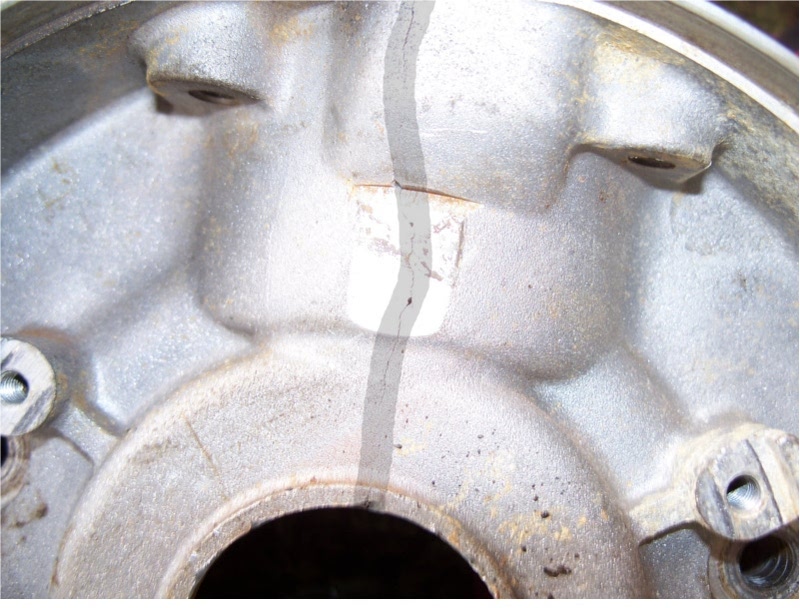

Also, a sad bit of commentary on the state of this engine. Splitting the cases was nothing compared to all the work we did on that cylinder. Not even close. Hahaha
Actually looks decent, though someone cut the wires off just outside of this picture. Probably just before the decided to store this poor bike in salt water.
I "highlighted" the crack since the metal kind of caught the flash and made it a little bright.
Very hard to see on this one, but you can pick out some points where you can tell its cracked all the way through.

Well, i don't know if i'd doom those cases based on the crack i saw in the pic... though the pic might not really show how bad it is.
Realize that the cases are most important around where the crankshaft sits. That area needs to be airtight and hold pressure, vacuum, etc.
Outside of that circular area the crank sits, the rest of the cases are NOT under pressure, and only really need to hold oil in.
And i'll say this - your parts there may be a bit rusty... but even if you toss the cases, some of those bits may still prove salvagable. Really, anything without a bearing in it can be blasted or wirebrushed. I would take a wire brush to that clutch basket and de-rust that. Your kickstart quadrant is good. Your kickstart gear is good. Your primary drive ( the big christmas tree shaped thing ) might be good after you replace the bearings inside it. The Gearstack is likely in fine shape after you wire brush it clean.
That crankshaft MIGHT be shot...because there's bearings in the area where the big round part connects to the "con rod".
But, these are completely good parts, even if they LOOK ugly. If it were mine, i'd be sending a lot of that stuff to be blasted and i'd still try to build the engine myself.
I hope you learned a bit in the disassembly process.
@rover_eric avatar
Posts: 6980
Location: Detroit, Michigan
@rover_eric avatar
Posts: 6980
OH ...forgot to add ... you can always have someone that can aluminum weld run a bead of aluminum down that crack to make sure it's reinforced, and grind it flat in areas where it needs to be ( like, where the stator would sit. )

By the way, I couldn't get the full gear stack out without having dad there to know what tools to use, but I pulled the kickstart quadrant out last weekend and went to Advanced Auto Parts and bought some cheapy brushes. You can actually tell the stupid thing is metal again! I'm amazed. haha. Once I get everything that's still usable brushed off, I may post another picture. I'm getting back into the swing of things, so here's hoping this project picks back up again soon.
61 VBB 150
Posts: 60
Location: orange ca
61 VBB 150
Posts: 60
Location: orange ca
Patience is important when it comes to breaking free stuck engines like that. A rosebud on an oxyacetylene torch used to heat the jug would cause it to expand, and allow the penetrant of your choice to sink in. The piston could have been sacrificed by cutting/drilling it out around the small end of the con rod, allowing removal of the cylinder and then it could simply be bored. I've read that a 50/50 mix of acetone and automatic transmission fluid is the best penetrant in existence. It all boils down to patience not big hammers and pry bars. What do doctors say? "First do no harm?" or something like that. Everyone has to experience a learning curve so I'm not beating you up, just trying to help.
