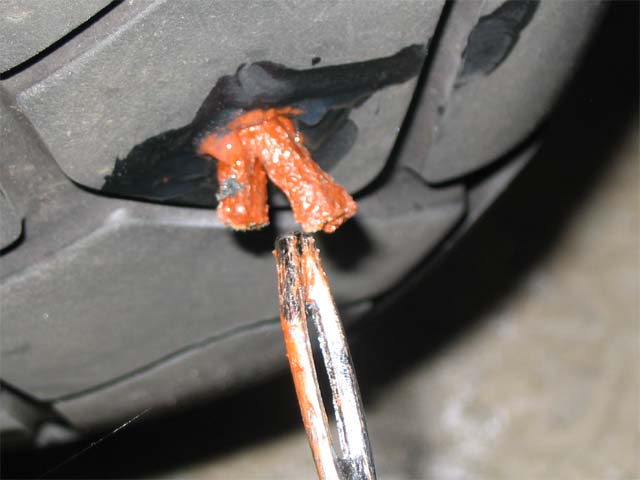

windbreaker wrote:
Just wondering whether a plug would interfere with their distribution inside the tire.
I think it might depend on the type of plug... If you use the Stop 'N Go type I'd say there would be no problem. The regular old snotty brown worm covered in glue type may not be a compatible as they may tend to stick to it...
Stop 'N Go plug:
Snotty Brown Worm:
Dave
