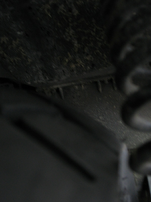

Replaced the rear MSG with METZELER FEELFREE 150/70-14 on MP3-400.
MSG has done 8700km = 5405miles of heavy riding.
So far after 50km on the new tyre I like it a lot. Leaving tomorrow for 1400km ride, will report my feelings after that.
One think to note, I now have like 3-5mm between the tyre and the shock absorber. I doubt very much that 160 size would fit on MP3-400 unless you move the right side shock a bit (if you can do this). I know that someone did fit 160 on Fuoco (MP3-500). This could be slightly different storry on MP3-400..
Shit photo but it is really very close to the shock..but still OK

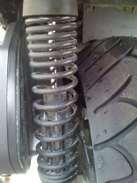

View of left shock and tire. Plenty of room.

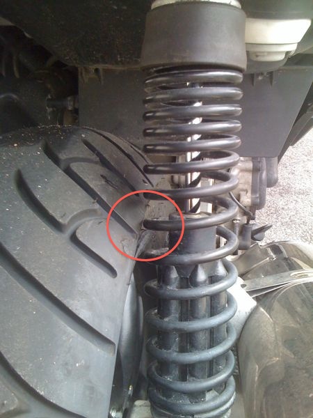

View of right shock and tire. Note close clearance that is highlighted.

Kevink,
Don't want to cause any worry, but looking at those pictures it looks as if the rear wheel is off centre somehow. Looking at the rear mudgaurd and RH shock. Surely the gap should be equal between the shocks?
Edit
Just been and looked at mine, I have a Continental Twist 140/70/14, the clearence between the shock and tyre on the LH is about 8mm, on the RH it's about 12mm.
This has surprised me

Soeley wrote:
Kevink,
That was my first thought, but riding it I don't notice any issue. I think with the larger tire the "offset" distance becomes more noticeable. I'll measure it today to see what difference I get.

Now if I could just figure out why the tire is not centered between the shocks. I have been concerned about the close proximity of the tire to the right shock absorber. I don't know why I have virtually no clearance on the right, but about 9 mm clearance on the left (see pictures from earlier post). However, the springs don't rub the tire (I put the shocks in the first two settings in testing this). I think my last tire was the same way, but with a smaller tire the gap was significant enough that I never bothered to measure the distance. Any insight on this would be appreciated.
