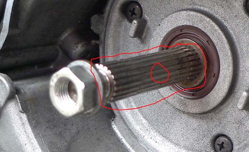

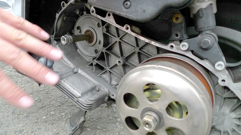

pics
Here's the photos I took yesterday.
Posts: 46316
Posts: 46316
Pictures of the crankshaft splines *after cleaning* would be good.

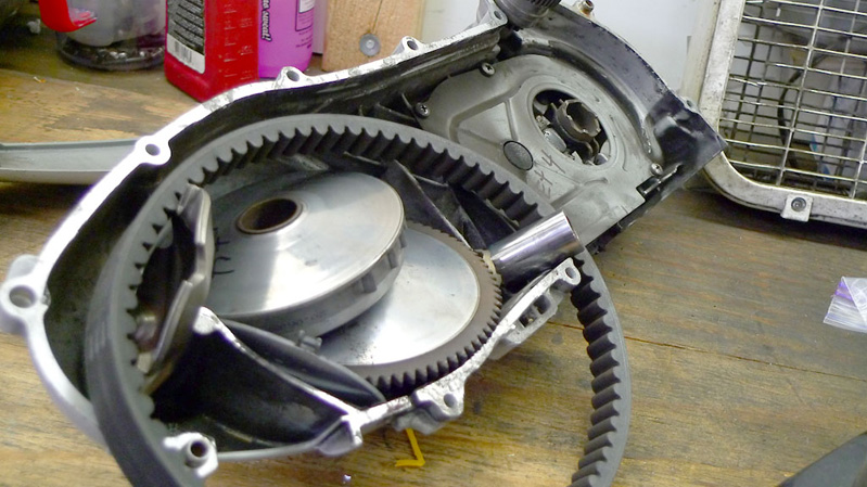

Here's more pics
I'm not really sure how the engine all works, but they told me that they could replace these parts (belt, and worn gears on attached pics) but the spline might not hold, and getting a new engine is the way to go. Are they taking me for a ride and trying to sell me a new bike?

I just uploaded pics that should show this. Thanks again.

OK your splines look fine to me. Get a new outer pulley half, new rollers and a belt. Get everything torqued down properly and I bet it works just fine.

How high are the ridges in the center of the sline supposed to be? The edges look higher - are they supposed to be that way? The shop said they could repair it without the engine for $650-800, but "can't guarantee those splines will hold". Where could I see a photo of "good unworn splines"?

How much? An outer variator half, belt and rollers won't cost that much - and it's only 20 minutes work max to fit. They are con-merchants - never go there again, they obviously don't have a clue what they're talking about.
The centre/rear splines aren't even absolutely necessary - they're not used with J Costa variators at all!

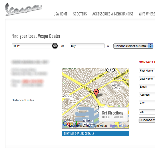

This place is supposed to be an authorized Vespa dealership, and is listed on Vespa.com's location search for my area. But that doesn't mean they're NOT trying to take me for a ride. Thanks for your input - I'll try to get a second opinion at another shop.
DougL wrote:
Oh and yes, you may be being taken in. Get someone who knows Vespas to deal with it, not a Honda dealer.

And Jim is absolutely right, the only splines that matter are right at the end. As I said they look normal to me.....

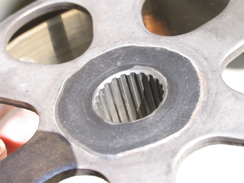

Good man Jim. Here is a pic of a GT200 pulley.
And its splined crankshaft
Have a look at this article from the Wiki. It may help understand how to do the belt change. Oh and edit your first post again to remove the price!
GT200 CVT belt and rollers replacement.

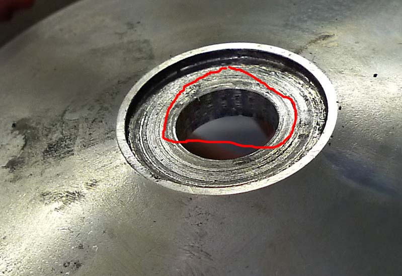

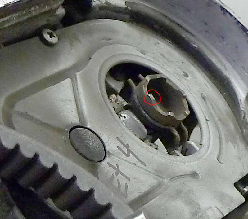

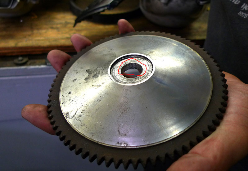

more pics
I just spoke with Vespa Sherman Oaks (located close to me) and they've been very helpful. I may tow it to them for a second opinion. Here's more pics of the rest of the engine, in case there's anything helpful shown here.

The bit you've circled in red is actually the kick start engagement. The bendix is shown just going out of shot in the top photo, above the kickstart mechanism. Why use a Vespa dealer and not one of the independents suggested by Harvey and I? Much cheaper...
Oh and your belt looks in good condition. How many miles on your ET4? Your bendix may of course be ok, and all you may need to change is the outer pulley half. They only cost the equivalent of about $50 over here....

Just FYI, I did strip the crank on our ET4, I had the nut at the end of the crank undo at 60mph.
I bought a complete second hand engine with 400 miles on it for $450 on ebay.
My engine had 14,000.
I swapped it out myself with a home-handyman type wrench set in a Saturday morning.
