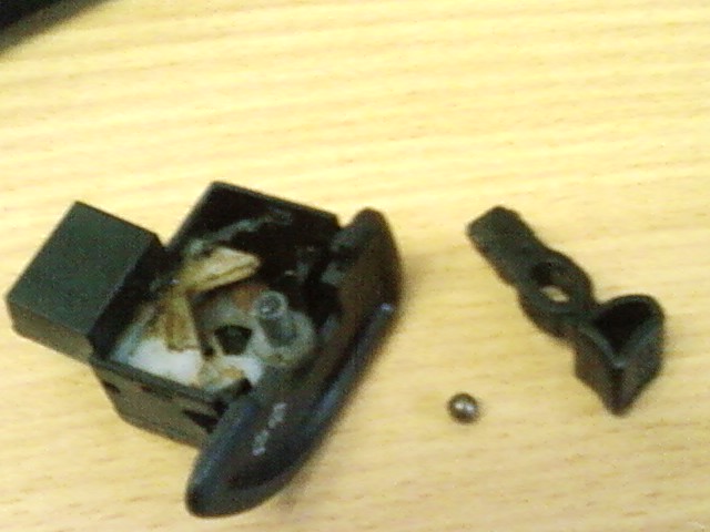

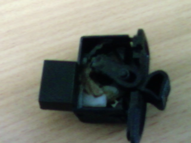

Fun on my lunch break.
Took apart the indicator switch. Noticed this little ball not being in any place in particular. Any ideas where it is supposed to go?
With the lid off.
With the lid off.
Taken apart.
Taken apart.
Posts: 46295
Posts: 46295
Yes.
There should be a tiny spring inside the far end of the button arm - and the ball sits between that and the V-shaped bit of metal (plastic?). Quite tricky to get back in place after the clean/grease-up, but not in the league of some 'metal puzzles'.
@glow_guy avatar
MP3 400-THMP3R
Posts: 478
Location: Atlanta
@glow_guy avatar
MP3 400-THMP3R
Posts: 478
Location: Atlanta
Ok, put it back together placing the ball as you said. I did that a couple of times with the same result. The ball escapes and then gets in the way of the movement. It seems like it would actually function without the ball in place. I think I will try this on the way home. Must be something missing that is supposed to keep the ball in place. I don't know. It seems that when you move the switch to either side, it causes the ball to drop out of position.
Posts: 46295
Posts: 46295
That shouldn't happen - it should stay in place once all is 'done up' again. It may well fall out if the whole switch isn't re-assembled.

Hi, some interesting issue raised here. I'm guessing I'm a victim of the dodgy Italian wiring. Its been pretty cold wet and snowy here for a month now and since Christmas Day my electronic seat release and rear luggage compartment have not opened correctly using the key, the key itself is fine,batteries ok. Sometimes it seems to work and sometimes I have to use the manual opening. The thing is only 8 months old with 1600miles on the clock. Also last night while steaming down the motorway in pitch black I flashed a vehicle to pull out and then lost all headlights only to have to finish my journey in dark apart from the small light at the bottom of the front fairing. On arrival home I fiddled with the switch and the lights flicker on so its seems to be definately switch related as for the seat release I have no idea. I'm not electrically or mechanically minded so on the back foot a bit.
I think the best thing for me to do would be to contact my dealer, this has to be a warranty job.
