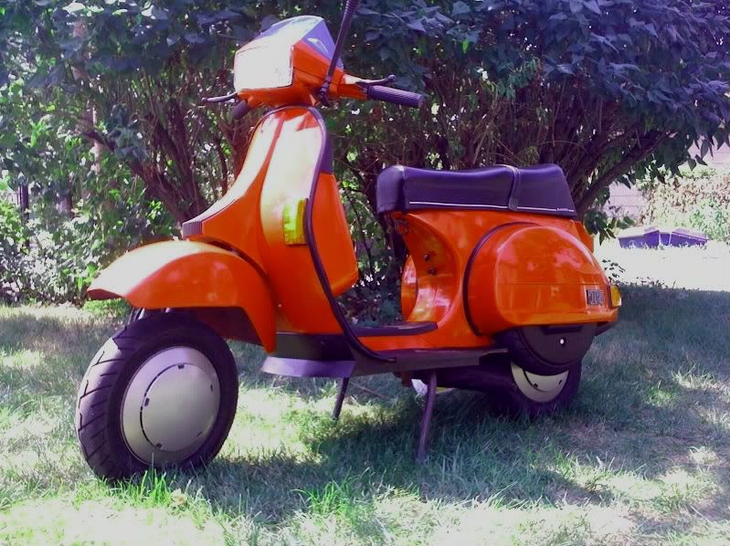

For those who say Rustoleum is crap, here's my T5 that I painted with Rustoleum last year. The color was a perfect match. No stone chips, no damage from fuel. The whole scooter except for the very back was painted. No clear coat on this, it makes paint damage easier to repair.
Do a search for rustoleum paint job and you'll find many articles from car enthusiasts who painted with Rustoleum.

Man, I like the look of that with those wheel covers. not sure if I'd do that, but it looks good.
my scoot is painted with rustoleum as well. so long as you now how to paint properly and do proper clean up at the end (sanding, buffing, etc. it can look great.
though I prefer krylon myself, it's just harder to find here and the color selection isn't what I want. We use krylon on the speaker cabinets in our sound system (25KW concert system, not some small PA in a garage), and it works great. the speakers take a beating on the truck between shows and get torn up at the shows from beer, dirt, fog, etc. after 10 years of everything from night clubs to multi-day outdoor events with the speakers just inches off muddy grass... they look beat up, but the krylon has protected them enough that they're not falling apart or rotting. which is better than expected

How does the paint on your fuel tank look? What did you paint the fork with? How does it look?
HOT T5!! I love love love them. Question, are the wheel discs dull silver (metallic) or more of a plasticky grey color?
I need some for mine and I got some from SIP that don't look quite right to me.
tR

Rustoleum works fine. It's just all in the prep work.

The tank is the original flat black factory paint. The fork is also the factory paint. I painted the wheel discs with plasi-kote car color #FM A135. That was the closest match I could find. The original paint was badly chipped on the wheel discs.
Thanks for the compliments As VLBJS1 said, it's all in the prep work. Also knowing how to color sand and buff it out after your top coat.
