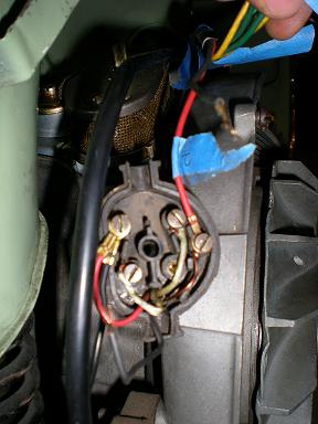

Previous owner of my scooter was in the process of rebuilding the engine, but was unable to finish. I'm working on getting everything reattached and working as it should, but am having trouble determining the wiring set up. The picture shows the junction box with wires coming from the magneto. Does each wire coming from the lights, horn, etc. have its own designated place within the junction box?

looks like you've got some non-standard colored wires there.
Give me a list of the wire colors on your HARNESS ...and the ones coming off your engine.

Take a look here:
http://www.scooterhelp.com/electrics/pages/VBA.150.html
Hope this helps.
