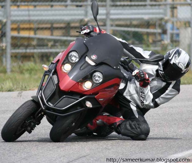

At 40 degrees, whichever foot of the centerstand that is inside of the turn contacts the ground. It makes a distinctive loud dragging sound and the foot will get a bit beat up but will not affect its function. It is not difficult to drag the centerstand; that noise is a warning to get a bit more upright (since this most commonly happens at slow speed, typically this includes goosing the throttle a bit). On a conventional motorcycle, this role is typically served by a bump protruding from the bottom of the footpegs, which like the centerstand are spring-loaded; if those harley riders lean too far over, the bump begins to drag and make a noise (and vibrates the rider's foot), but because they are spring-loaded it is unlikely that the footpeg will actually snag the ground and cause a crash (unless the rider ignores the noise and attempts to force a further lean, of course).
Because the centerstand lies along the scooter's centerline, this is true regardless of strut compression. If you have added something that projects sideways beyond the scooter, consideration must also be given to the fact that centrifugal force will compress the inboard suspension strut, so something that appears to be at less than 40 degrees can still contact the ground before the centerstand when executing maximum lean turns at higher speeds (add-on footpegs are an example).
If the centerstand is removed, or (according to others on this forum) larger tires are installed, it bercomes possible to lean slightly more than 40 degrees, in which case the muffler guard or engine casing will contact ground first. Since they are associated with things more important mechanically than the centerstand and not spring-loaded, that's presumably not a good thing. There is also going to come a point where you have maxed out available strut compression (which would mean if you lean any further, instead of having two tires on the ground in front you'll have only one, with the other hanging in the air), but because the MP3 has a remarkable amount of strut travel you will have long since dragged the centerstand, muffler, or something else. I imagine it's possible to lose contact with one wheel during a maximum turn on uneven terrain, but as the picture below proves, on flat ground all tires will remain on the ground at maximum lean and maximum strut compression.
The new MP3 hybrid has a rather large electric motor protruding from one side of the rear wheel, and it has been speculated that that motor (or more specifically, a steel tube that encompasses it) will be the first thing to contact ground when leaning to that side.
Maximum lean, maximum strut compression - check out where the left tire is relative to the wheel well.

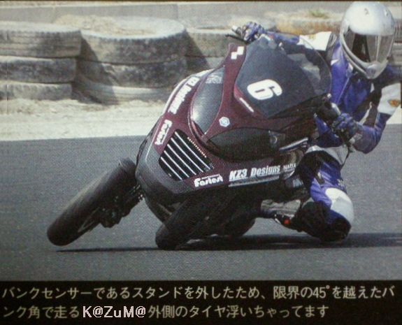

There is a picture posted here somewhere of one leaned far enough to raise the outside wheel off the ground.

Here is a photo of a wheel off the ground on one side. Center stand must be off, and it looks like the variator housing might be dragging.
